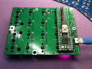

« Reply #114 on: Mon, 22 April 2013, 15:12:13 »
Note:  This isn't the GHpad that komar007 is working on.
So my test board is alive... but it's not the same one that JDCarpe has... I decided to go a different route - everything is through-hole.
"What? through-hole? That's so passé!",  I hear you cry.   Well, you know, I tried some 0805 SMD, and I didn't have fun with it, so I figured I would try to fit a Teensy... but you can't fit a Teensy on a 4x5 keypad... so I made it a daughterboard.
So I got it working with Hasu's firmware yesterday after realizing that I had put all the diodes on backwards  :-[  so please excuse the messy repairs...
19458-0

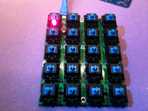

So here's the board, numlock lit, waiting for those Retro DSA caps to show up...  I ordered a case for it from Shapeways, we'll see how it turns out... never had anything 3d printed before, and I'm new to 3D design.
19460-119462-2

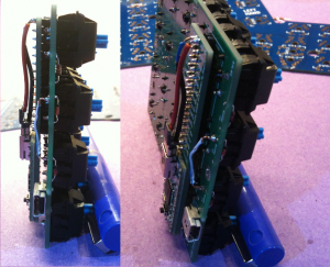

You could get a little more space if you took off the button and the usb connector, but there seems to be enough space in the poker case I was testing with anyway, so that's what I based my 3d thingy on.
19464-3

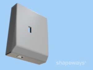

« Reply #116 on: Tue, 30 April 2013, 18:58:10 »
The shapeways print arrived today, and I stuck the keypad in there and threw on some random caps I had.
The material itself is very odd, it's not smooth at all, it's kind of rough and raw... needs some work.  That said, it's also white if you scrape at it with a knife or other tool (which I had to do because the USB was somewhat misaligned).
20495-0
I got impatient and ordered it before finalizing any sort of PCB mounting, so it just kind of floats in there.
20493-1
I'll call it a learning experience and use it for a while...
20497-2
It certainly seems to be good enough for now :D
