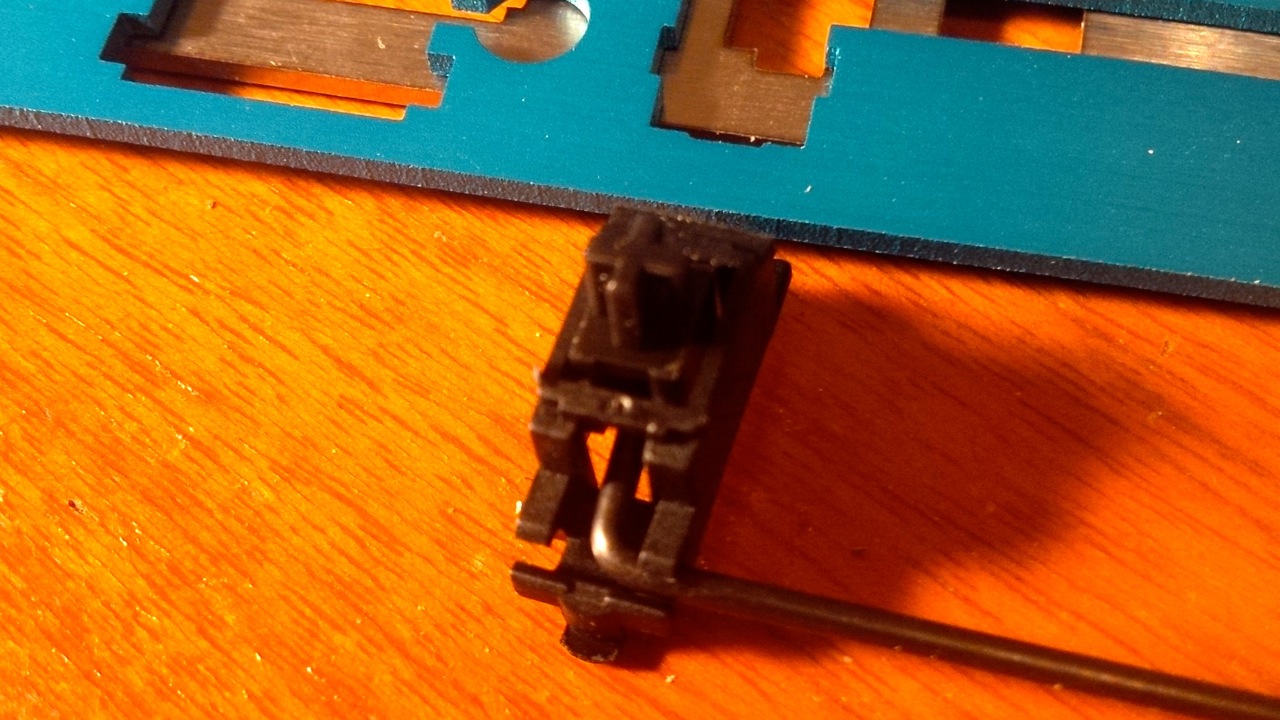

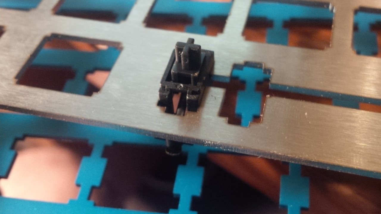

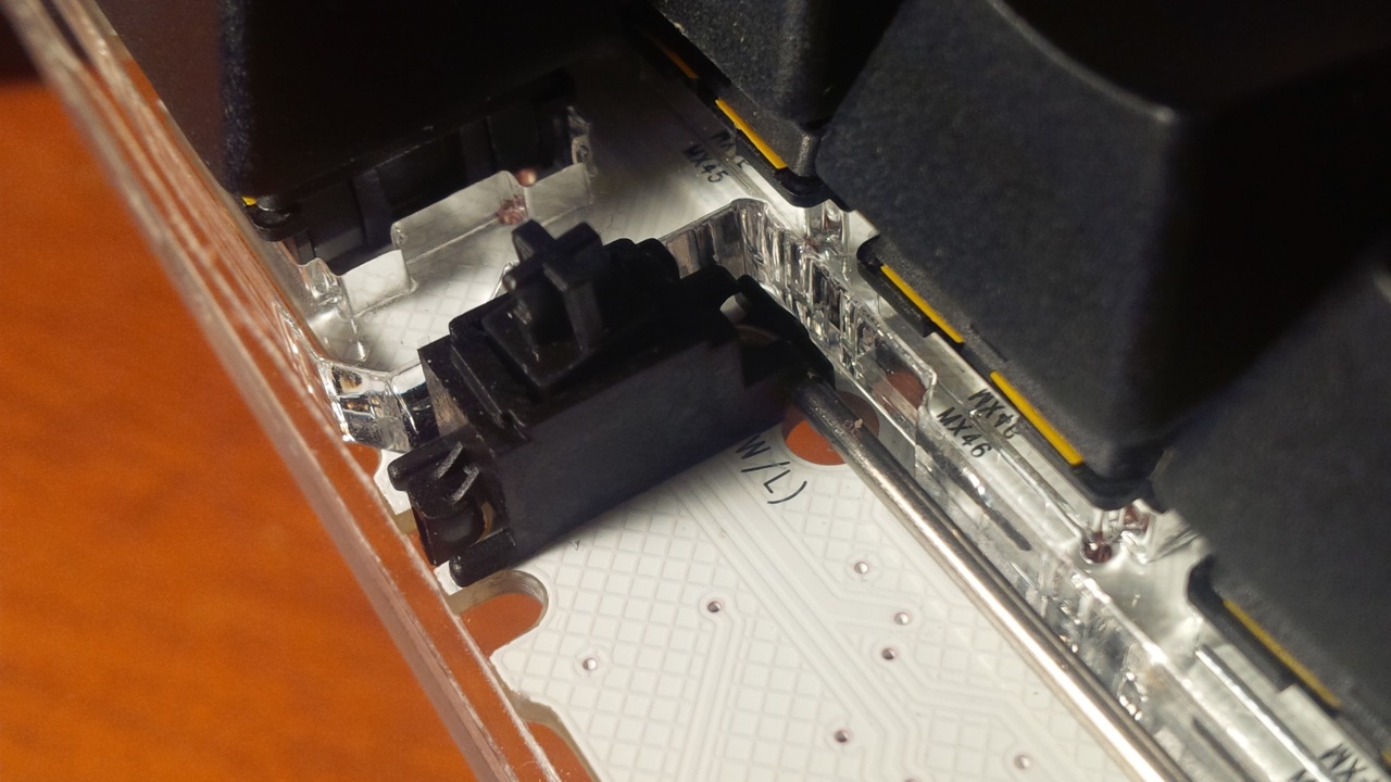

I was asked a question via PM and I thought the answer would actually be interesting to a larger audience, so here it is...
The question:
Can I solder the switches before I attach the stabilizers (cherry style)?
Are the stabilizers just popped in or are they secured in any other way as well?
My response:
Disclaimer:  I am not an expert.  Everything I know is based on research and limited experience...
That being said, I am more than willing share what I know.
To get started, there are two different types of Cherry stabilizers; plate mounted and pcb mounted
Do you know which type you have?  What pcb are you using?  Are you using a plate?
It is easier to explain how both work by letting someone else do it.  :)  >>> YouTube >>>
So to answer your question.  You need to add plate mounted stabilizers before you solder on the switch.  You can remove pcb mounted stabilizers with the switches soldered in place if you are not using a plate.  In some plates (like spirt's 5mm acrylic plate), you can (and need to) use pcb mount stabilizers with the plate because the whole area is cut out, so both the switch and the stabilizer is actually pcb mounted.  In this case, you can also remove the stabilizers with the switches soldered on.  I just checked with the universal tkl plate and with an IMSTO 60% plate and I could use cherry pcb mount stabs with both, BUT, you would have to desolder the WHOLE BOARD if you want to change them, so you would absolutely have to put them in first.  I would not recommend that, you would want to get plate mounted stabilizers in that case.
Here are some pictures that might help you understand.  These are pcb mount stabilizers and the different plates mentioned above.

Offline Razor Lotus
  • Posts: 351
  • Location: Singapore/United Kingdom
Re: Simple Questions, Simple Answers (FAQ in the OP)
« Reply #8613 on: Tue, 24 June 2014, 02:16:29 »
But they are interchangable right?
Like the pcb would support both pcb and plate mounted stabs?
Just that if i'm lazy to go source for a plate mounted stab, i would have to mount the pcb stab first and desolder all the switches if i want to change anything. If not, i should just get a plate stab and mount it like a switch?
Offline BlueBär

1. The PCB needs only space and nothing special to support plate mounted stabs. Since the Pure already supports PCB mounted stabs you can use both types.
2. Yes.

If your pcb does not have pcb mount stabilizer holes, you would have to clip off some plastic to use pcb mount stabs with a plate.
That won't work, then there will be nothing to hold the stabilizer properly in place.

I will take your word for it. U assumed that it would be locked between the plate and the pcb so it would not move. I could be wrong, but with my quick inspection it looked to be possible.
Offline BlueBär
  • Posts: 2231
  • Location: Germany, SB
« Reply #8618 on: Tue, 24 June 2014, 11:48:34 »
I don't have something to test it but according to the spec sheet and my own measurments, plate cutouts should be too big to hold it down. The holes should be just as wide as the bases and about a millimeter longer.
Besides, I don't think that is a good idea anyways. Plate mounted stabilizers exist for a reason and they have a latching tab that fixes them to the plate, if you would use your idea there is really nothing but pressure from the top that holds them in place. Assembly would also probably be quite the hassle.

Absolutely not recommended. I think it would depend on the plate. I think it could work with the plates I was looking at (universal TKL and IMSTO 60%). The pcb stab fits through the imsto plate pretty easily. On the universal plate it barely fits through and was hard to remove after. It definitely would not go completely through the plate.
Get the right part for the job is always the right choice.

no difference.  you basically just pick whatever your pcb supports.  a lot of the older pcbs only support through hole diodes.  some of the newer pcbs (like from sprit's gb) actually support both smd or through hole diodes, so you can choose which you want to use.
here is a picture of a pcb which allows you to choose which type of diode you want to use.
69018-0
