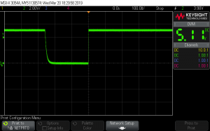

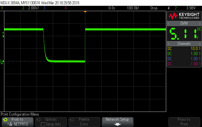

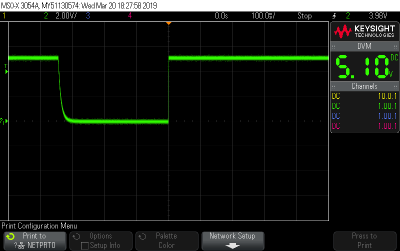

I watched the TaranHV Video on YT and I convinced myself this USB to USB converter is a gem.
A few weeks later I had already four HASU USB USB converters delivered from Japan to Germany, thanks HASU.
I flashed the F24.hex founded here:
https://github.com/TaranVH/2nd-keyboard/blob/master/HASU_USB/F24/F24.hex
Unfortunately I am also experiencing massive reboot problems.
At work (Win10 1803, Keyboard HP KU-1156), there is no way I can get it working after a reboot. Tried everything: Monitor USB Hub, With or without docking station. Laptop HP won't play nicely with the converter.
At home I have a Lenovo P51 and a Desktop PC. In the Desktop PC I occasionally get it working if I connected it at the monitor USB 3.0 hub otherwise no way.
Tonight I focused on the P51, Win 10 Pro 1809, keyboard HP KU-0133.
I am a EE so I fired up my scope to understand what happens on the 5V USB during a reboot.
I used this USB jig to separate the 5v power buses:

Here what happen with a  50OHm resistor connected between 5V and ground,
with AC charger connected
without AC Charger
I tried then to feed both HASU USB Converter with an external 5V source to understand if something was changing. I tried to keep the 5V constantly on the HASU Conv. connected with the keyboard or just at the keyboard without USB Converter. See pictures:
No changes, always no keyboard after reboot.
So I decided to plug it directly to the Lenovo P51 and run some tests.
Statistically here what I got
device manager ok means I got the device HID\VID_FEED&PID_005B&MI_00\7&391144F0&0&0000 in the device tree.
what scared me the most, at a certain point the HASU USB was blocking the PC boot, the Lenovo was stuck with the boot logo on the screen. Anyway after a replug everything was ok.
To me everything works if I plug the keyboard AFTER I connect the HASU to the PC. Maybe putting a transistor which enable the 5V keyboard after the handshake with the PC has completed could help.
