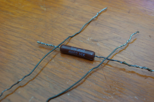

I bought two different versions.  One has three connections and the other only has two.  The one that has 3 connections has a lot of plastic on it and this is being installed in a relatively hot environment, so I want to remove as much plastic as possible from the equation.
The one I am replacing only has two connections.  It is implemented as a very low tech heater.  Basically power comes from the jack and goes directly through a 5W 20Ohm resistor.  That resistor is installed in a heat sink which warms up...
Here are some images of the setup.
50259-0 50261-1 50263-2
Another question:  I believe that resistors do not have polarity, so it should not matter which orientation the resistor is installed in right?  I forgot to document that when I was taking it apart because I knew it was a resistor and I didn't think it mattered.  Well and I knew if it did matter I could figure it out after and it was really hard to get apart.  :)
Yes, resistors do not have polarity, you can install them either which way.
^^ +1.
