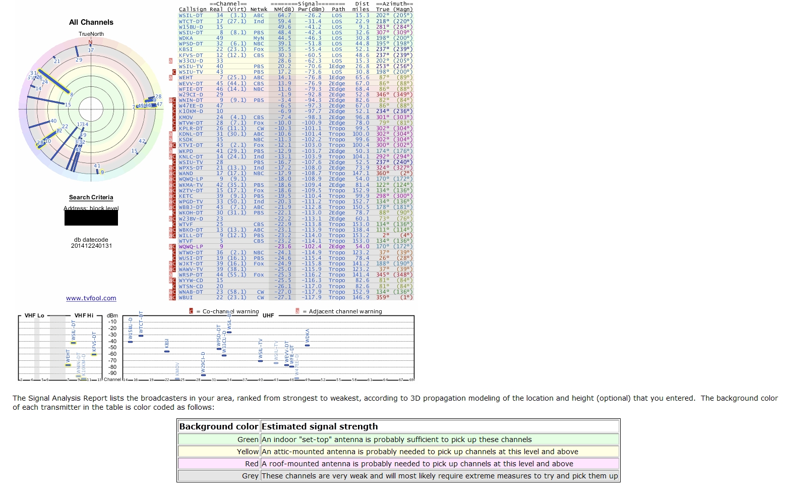

I live in the sticks and will soon (hopefully sooner than later) be moving into a new house and am thinking a nice tv antenna would be handy to have.
Anyone have any recommendations? I'm not overly concerned if it goes inside or outside.
Perhaps some DIY project that you've had success with?
Here is my tv fool evaluation.
86885-0

I picked up an Antennas Direct DB4 a few years ago along with an Antennas Direct amp and have been very happy with it. Mine is mounted just bellow the soffit on my roof and I pick up every channel shown through yellow by the tvfool site. My dad owns the DB8 version and has never had a complaint with his.

I've looked into the DB4 before seems most people really have good results with that one, thanks for the recommendation.

Another vote for antennas direct.  I think the DB4 has been discontinued and replace with the DB4-E; essentially the same thing with a few curves.

You may be able to get away with the smaller DB2 style unit.  It's basically half of that.  There are also many clones of the design, often cheaper, and you can even build them yourself.
I use one of these http://www.amazon.com/Eagle-Aspen-EASDTV2BUHF-Directv-Approved/dp/B000GIT002
The big thing though is, if you have a stucco house, you've gotta mount it outside.  The chicken wire inside stucco forms a Faraday cage, so you'll get dramatically stronger signal if you just even crack a window and hang the antenna outside against a wall.
