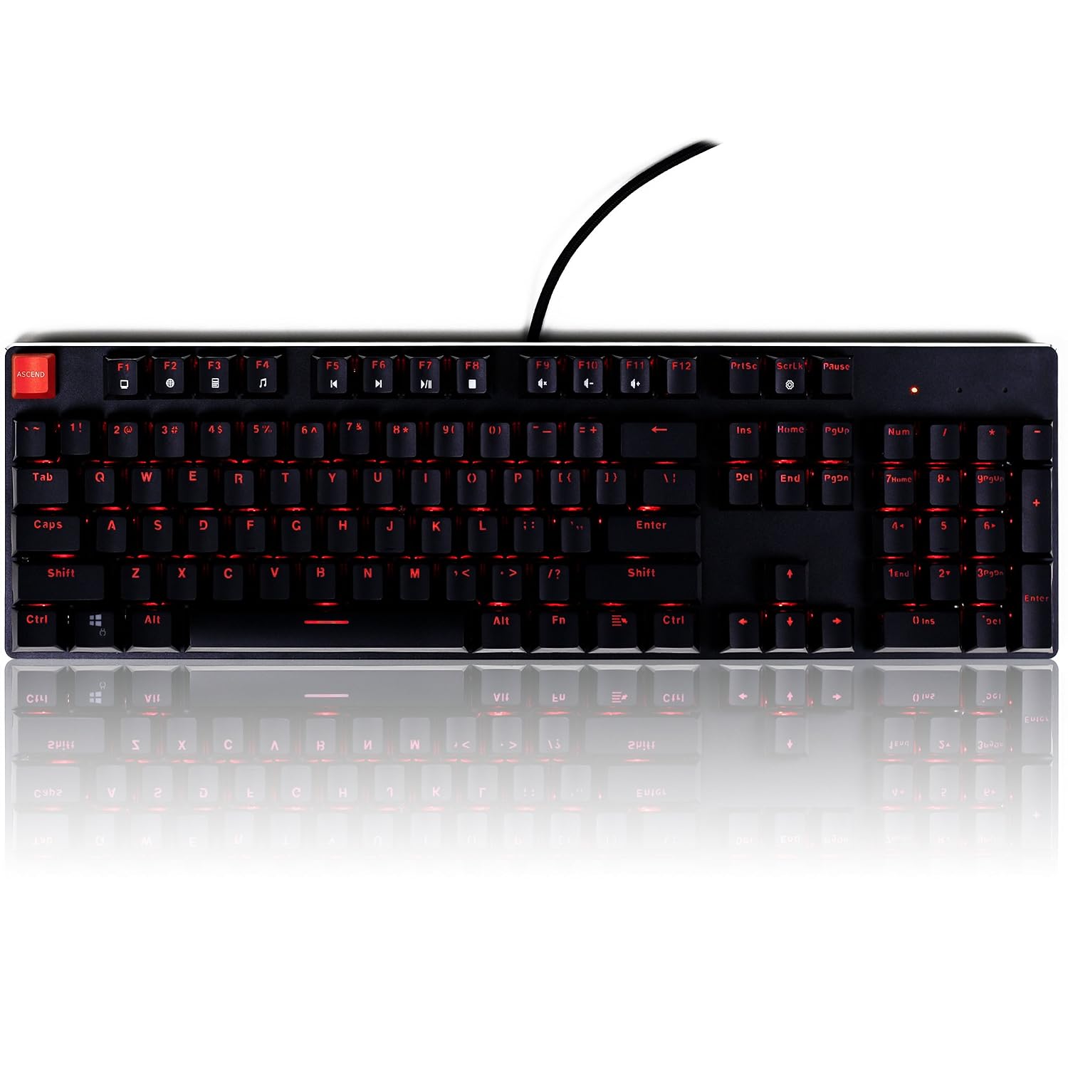

I was going to suggest the Glorious Modular Mechanical Keyboard, which allows you to easily pop out and swap switches without soldering, but it's a full sized board, not TKL.

Is there something comparable for a bit cheaper?
Yes, The Glorious Gaming Mechanical Keyboard.

« Reply #16 on: Thu, 27 October 2016, 18:10:55 »
Sorry, i guess i should have said similar to the Ducky One.
To me, this looks pretty similar, unless you're talking about the TKL:
Offline Simia_4
  • Posts: 17
Re: Swapping out switches
« Reply #17 on: Thu, 27 October 2016, 18:21:55 »
Yep, TKL.

If you want TKL instead of the Glorious gaming board which is Full Size, how about something like the Zhuque board, its simlar where it has SMD-Leds and the switches are hot swapable as well
here is a review
Its avail at Amazon and a bunch of other places, cheap too.
I don't think the stock one comes with brown switches so you will have to find some switches and swap them, which is easy on this board.
