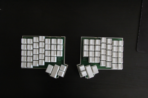

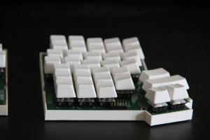

I worked on this during the summer and some of my friends were interested, so I made a bunch of them. First, the pics.
Here is the completed product!
177795-0
A side shot.
177797-1

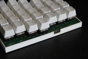

The mini-USB connector.
177799-2

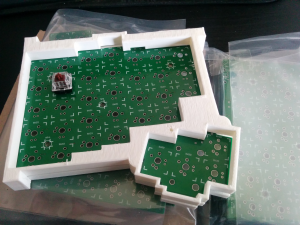

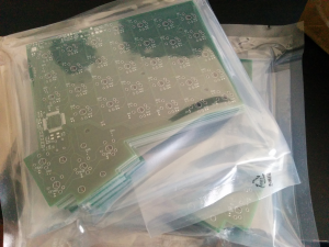

The PCBs in their casing from the manufacturer. I got these made in Korea by Quickturn PCB. Quality is great and they're fast! Arrived in the US about 7 days after I ordered them.
177801-3

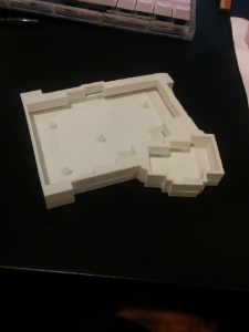

Meanwhile, prototyping the case with a Makerbot. Seems to fit together well, the top and bottom halves are held together by various protrusions on the outside of the top that 'clip' around the bottom half.
177803-4
Here the PCB is inside the case; the case was a little too small though, forgot to add some extra space to the outside. Fixed that in later prints though.
177805-5

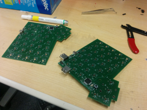

Soldering the very first one! Started around midnight, finished around 5AM...
177807-6

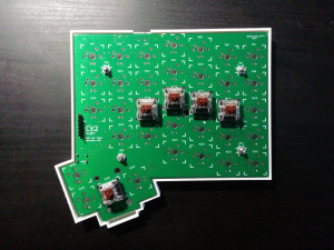

Soldered the home row switches on

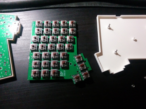

Now all the switches are soldered on

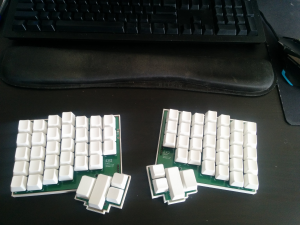

Keycaps all on! I designed the spacing so a regular 87-keycap set would work. I like the blank keys, as you can see.
177813-9
And that's a wrap!

So the right is the slave and only has the micro usb. The left side has the micro from the computer, one usb A as out to the slave, what is the second USB A?
Offline patosai
Re: EX2: Ergonomic Split Mechanical Keyboard
« Reply #8 on: Sat, 09 September 2017, 00:53:16 »
One of my friends has the Ergodox EZ and I tried it out. I thought the thumb positioning was too far out so when I made this I made sure to move it a little closer.
There's two USB As because that's supposed to be a USB hub. The two halves are completely separate and can be plugged into the computer separately.
The dream:
  - connect one half to the other
  - connect the other half to the computer
  - free USB ports on the other half for other uses (mouse, phone, etc)
But the USB hub hasn't been cooperating... so there's no USB hub for now.
