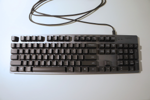

Here the first picture as you can see it's pretty much the same design as Logitech G413 but without the backlight.
But this is meant to be for their office line so the choice of font is nice and clean.
177933-1 177935-2

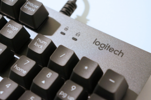

Notice instead of the typical Caps Lock, Num Lock, Scroll Lock, it has simplify to only having Caps Lock and Windows Lock (more of a gaming feature).

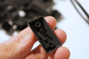

Keycap is ABD pad printed, during regular typing you won't notice the raised legends.
177939-4 177941-5

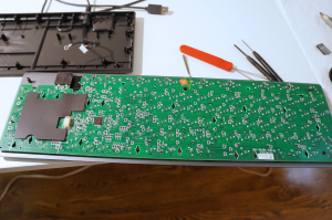

So any geekhackers would do, MOD TIME (keep in mind this is my 2nd day owning the keyboard so I'm basically voiding my warranty).
177951-10 177953-11 177955-12

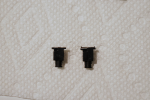

Time to bust out my trusty Gundam clippers and clip those legs.
177957-13 177959-14

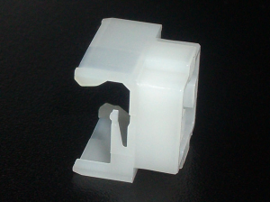

I'm not sure if you can see here, but in the middle white piece, left and right is their side wall which uses to stabilizer the switch.  But top and down in the middle white stem USED TO (not anymore) have "cushion legs" similar to Cherry stabilizer that is used to dampen the bottom out.  The picture on the right is pulled off Deskthority Wiki and it shows the cushioned leg of the OLD VERSION.
But ever since all the complaint about it feeling like rubber dome, Omron has since taken out those "cushion legs" so now the switch feel as clean as Cherry switches (hard bottom out).

New Romer-G feels nice, the old one used to feel a bit mushy but the recent update made it feel nice and clean and less wobble than Cherry switches.  Probably because of the wider stem so there's almost no wobble, the tactile point is also right at the top.  However for my preference I think I still prefer the 4 mm travel (Romer G is 3 mm).  I guess it's mean for gaming so it's shorter travel.
It states 45g activation but this actually feels slightly heavier than MX Brown.  The tactile point is also a bit more pronounced than MX Brown but less so than MX Clear.

Solution is to clip off the "legs" as demonstrated.  First you need to desolder all the switches with stabilizers on them (7 for full size keyboards, 4 for tenkeyless).  After that you can press on the tiny tabs behind the mounting point behind the stabilizer mount and rotate towards you to get the plastic mounts off the metal plates.  The metal wire can slide through the gap on the plate.  Dessemble the wire, get the stems out, clip them, then reverse the process to get everything back in.
