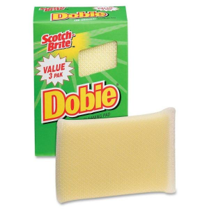

Why so stingy with soap? I like powdered laundry soap (I use a "green" unscented product like "Charlie's Laundry Powder") along with an "oxi-" product and/or some washing soda, about half a spoonful of each in a liter of hot water. With a 10-20 minute soak and thorough rinse (back and forth from the bowl of fresh water to the colander at least twice) I almost never find any remaining dirt, and I have cleaned keys much dirtier than yours without resorting to additional hand action except on rare occasions. And I have never bothered with denture tablets.
Similarly, the laundry soap seems to work better than dish soap on cases, too, and I swear by the "Dobie" scrubber for cleaning (including for actual cooking utensils). They are stronger and rougher than sponges, but not as harsh as Scotch-brite scouring pads - just right.
155491-0
For adhesive residue I use naptha (old-fashioned cigarette lighter fluid) or citrus oil  * BUT *  - test first, work very quickly, and remove all residue ASAP.
For really stubborn marks: pencil eraser or white eraser/scrubber pads  * BUT *  they quickly remove surface texture if you are too aggressive.
Shielding stickers directly with masking tape is risky, but cutting a plastic shield and taping it down with masking tape just slightly larger is a good way to protect it for at least enough time for a quick bath and dunk.
edit - a dead credit card works great for that "shield" but masking tape only lasts a couple of minutes under water

Good points! I hadn't thought of using laundry detergents, but then again some of them are quite aggressive. I use so little soap because if you use lots of dish soap the bubbles don't get out even if you soak them ten times, it's horrible. Doesn't really help anyway, the surface tension is already super low even with that little.
Naphtha is basically the same as the solvent I use. Basically any highly apolar solvents will work, though.
