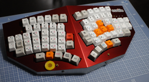

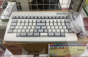

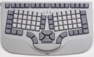

Finally, to go a bit on a tangent, some years ago when I started learning about keyboard design, I always assumed that row staggering is bad and ortholinear is good, but that's not universally true of every design. If you don't want to rotate the two halves (split angle) you can, symmetrically, row stagger the keys and that should get you part (most?) of the way there.
For instance on a standard keyboard, the row staggering on the right side helps align your hand with the keys, but of course it does the opposite on the left side. You need to twist your left hand unnaturally outwards in order to hit the reverse staggered top row and this is why touch typing lessons teach pressing "c" with the middle finger instead of the index. This is also why stepped caps-lock keys were introduced. With a twisted wrist, an overextended pinkie fans out further to left, causing mistypes. A stepped caps-lock is really a band-aid solution to serious design flaw.
My inspiration for this design were the Esrille, the NEC PC-9801 and the NEC Ergofit and only when I started testing their design choices, I appreciated and understood their elegance.
262874-0262876-1262878-2

Found another recent project with a similar approach of designing around the finger arcs of a tented palm, taken to its logical conclusion. It's the Willow64.
263139-0
I think the concept is sound, but when you start rotating rectangular keys, the distances between the keys increase and it's hard to contain the size and shape of the keyboard, which obviously has happened here.
Nevertheless, it's very interesting and unique and the Japanese creator has a nice blog writeup. There's also some discussion in the creator's posts on reddit.
  • Posts: 13680
Re: A symmetric stagger, ergo design
« Reply #17 on: Sat, 27 February 2021, 12:54:36 »
The layouts is impactful on FLAT keyboards because of how deeply the wrist has to rotate inwards.
With Proper Tenting, 45* Degrees and up,  you don't need these complicated arcs, it makes no difference.
This is the same principal which applies to the discussions on the ergodox's thumb section, where people complain it's too far from the core.
It's not too far,  it's only too far, if your wrist has to rotate inwards to hit it.  TENTED, it feels at the perfect distance.
very interesting... never thought about it like that but yes, when flat i do see it. instead of coming straight back down the column, if your hand is more relaxed/normal positioning (palm arching towards center) you can shift almost a full column from row 3 to row 1 (if spacebar is row 0)
Yes, you are right and we have been in agreement about tenting since earlier in the thread.
A tented, column and height staggered, split keyboard with concave keywells in a non-qwerty layout, is considered (although not universally) the holy grail. If e.g. you are an author typing millions of characters, you should definitely consider one of those. Although a stenotype would be significantly more efficient, not to mention speech-to-text has come a long way. And to think that there was a time, not that long ago, when people actually used pens to write books…
My goal here is not that holy grail (there are other keyboards aiming at that), but to find out how far can you push (ergonomically) a flat, one-piece keyboard, without requiring specialty keycaps, while trying to keep shape and dimensions contained. Apart from the Willow64, I haven't seen any other keyboards taking into account the -tented palm on a flat keyboard- aspect of typing.
That's a good observation and also putting the two halves further apart (shoulder-width apart) might also help, since that would require less/no tenting.
For this reason, I believe that tented and flat keyboards shouldn't have the same layout and if you design a keyboard that works well tented, you should offer it in a tented format, like the Esrille for example, and not as an optional extra.
  • Posts: 13680
« Reply #20 on: Sat, 27 February 2021, 17:11:18 »
the amount of tenting required is determined mainly by the elbow's height relative to the desk that the board rests on.
How far the arms are apart does not change the tenting angle by much.
To bring your hands closer together usually means lifting your elbow, that's why you may feel like the tenting angle needs to go down,  but that's not due to the hand's distance from each other, it's due to the Elbow change
