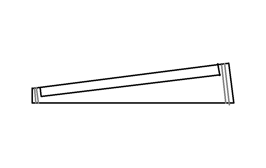

We're coming along pretty good.   :)  I'm slowly working on the layout and whatnot.  I'm thinking it should be full LED, yes/no?
Photekq, I have some suggestions about the basic concepts.
I really think the case should support the entire back of the PCB.  I am a big fan of adding a pad behind the PCB which would be impossible with your design.  It really helps to absorb vibration, because there are no supports from standoffs in the middle of the matrix.  Again, take the KMAC as an example, it's how they do it.
Check out this crude drawing to illustrate what I mean.
21195-0
Note the screws are perpendicular to the top face, not the bottom face.  Wouldn't that be a more appropriate attachment for the two halves?

« Reply #16 on: Mon, 06 May 2013, 12:21:59 »
I see what you mean. So you want the hole in the bottom half to be shallow and to be angled so that the pcb is parallel to the base and can come in contact with padding. Is the picture attached ok?
How deep should the hole be from the surface of the plate? According the Cherry's specsheet it's about 8.5mm between the surface of the plate and the bottom of the switch pins.. How much extra do you want to allow for padding? 10mm deep sounds good to me.
Also, I think the screwholes should stay vertical. If they were at an angle they would take up more horizontal room. This would mean you'd have to make the front an back faces thicker which, imo, makes the case look worse. It's up to you though. Having them at an angle wouldn't stop it from functioning.
I'm confused by this statement.  By my understanding, the opposite would be true.  By having the screw holes not be parallel to the exterior walls, they need more material to live in.  The 'vertical' screw holes come very close to the cavity.  We may need an(other) engineer to weigh in.  The front face and the guts (keys, pcb) are oriented together, so I like to think of that as the 'flat' side.
Re: Wanted: Nice case design to house a custom 10key+
« Reply #21 on: Mon, 06 May 2013, 14:42:45 »
What I'm saying is that they take up more space horizontally. See the diagram I've attached.
The problem is that in order to make the angled holes work you'd need to make either the front or side walls of the case thicker.
I may be wrong, but this is the way I see it. Maybe CPTBadAss would be able to help.
« Last Edit: Mon, 06 May 2013, 16:08:23 by Photekq »
The problem is more like bearcat said. You have to have tooling to hold the parts in and moving/rotating/swapping parts is going to be an issue. I would keep the holes inclined because otherwise, the screws won't sit flush if we're bolting from the top down (from the top, into the plate, into the base).
