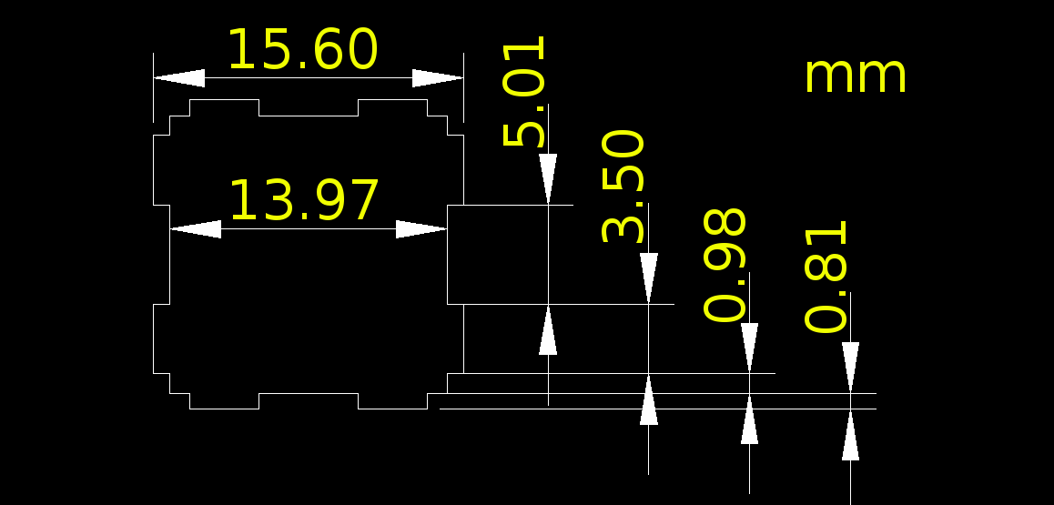

Added the only picture with measurements that i could find in this thead to mm. (wth, SAE? are you guys fro real? :)
anyone can help me with the mount that only has the extra 4 spaces (2x2)? i think that is the best one.... can't find the exact measurements for that one.
I have been looking for this in mm.  Is this pretty accurate?
I also read previously that two 1x1 switches are 19.05mm from left side to left side of the adjacent switch, but that was the style with built switch openings on the whole side (and the measurement was from the outside of the wing opening).  It should not matter because it was the same on both switches (I think).  So that would mean that the switches are 19.05 - 13.97 = 5.09mm apart?
Also, I am looking for the standard plate sizes (outside dimensions) in mm for the poker and tkl plates.

Sounds awesome. I wouldn't use those switch hole shapes, though. Unless you have randomly 90-degree rotated switches, you don't need the cutouts on the top and bottom. And it makes the switches less stable in the plate.
You should get with ne0phyte. He added some type of automated script to his layout generator to create plate drawings. His tool is at ne0.cc/laygenV2
Actually, the switch hole I recommend is a 12.8x15.6mm rectangle centered in the 14mm square. That hole will work for both MX (with easy open tabs) and Alps.
Excellent.  I was not sure what the best switch cutout was, so I used that one because it seemed to offer the most 'features'.  I will make it possible to select which type of switch cutout people want to use.  I will make your suggestion the default.

I just implemented my script using these measurements and I realize that something does not make sense with these numbers.  The distance between the centers for a 2u should not be double that of two 1u switches.  If that is the case, then the 2u switch actually takes up 3u of space because it has a full 1u on each side of the switch.
Here is an image to illustrate what these numbers work out to:
I think the numbers you have there is actually the 'space the key takes up with the key spacing accounted for', rather than distance between centers.  For 1u keys, yes, it is the distance between centers, but for the larger keys I think you have to split the distance to some extent.  I will play with this more tonight to figure out the actual algorithm to get these to line up correctly.
Thanks for the feedback though, you got me way ahead of where I was...  :)

I spent a bunch of time with the Cherry spec and a caliper tonight and I modified the suggested dimensions of this 'rotatable' switch opening.  The problem with the previous cutout dims was that on the non-flap sides, only the clip caught the edge, not the actual switch body.  I have made some minor modifications so that the middle section on the non-flap sides with now (barely) catch the edges of the switch body.  It only catches it by a couple tenths of a mm on each side, but that is all I could risk and still make sure the flap openings did their job.
Here is an image of the new dims I have come up with:
Note: the hard to read dimensions in the top right are: 0.8mm and 1.0mm

I was JUST looking into this.  :)  I just switched tabs over from the Cherry spec: http://www.cherrycorp.com/english/switches/pdf/mx_cat.pdf
In the OP of the GH CAD Resource Hub, I found the following (and the associated DWG which I am trying to get working in FreeCAD right now).  I may choose to use the universal stabs for everything, but I am not sure.  Maybe I will implement both the standard stabs as well as giving an option for people to use the universal stab type.  I am actively working on this right now, so I will have a better idea how I want to solve this problem later tonight.  :)  Thanks for the heads up...
