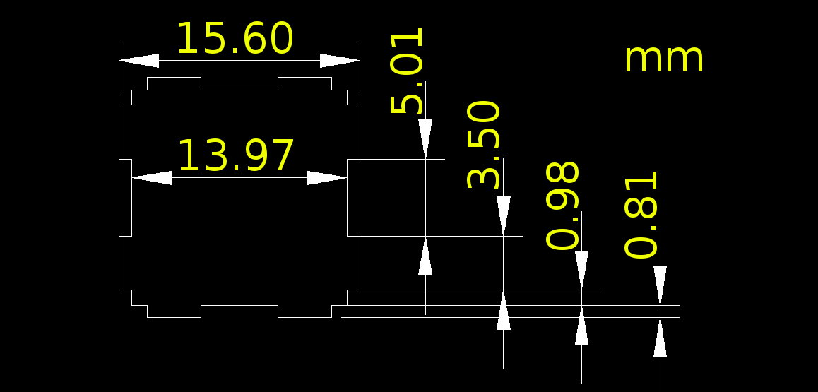

Added the only picture with measurements that i could find in this thead to mm. (wth, SAE? are you guys fro real? :)
anyone can help me with the mount that only has the extra 4 spaces (2x2)? i think that is the best one.... can't find the exact measurements for that one.
I have been looking for this in mm.  Is this pretty accurate?
I also read previously that two 1x1 switches are 19.05mm from left side to left side of the adjacent switch, but that was the style with built switch openings on the whole side (and the measurement was from the outside of the wing opening).  It should not matter because it was the same on both switches (I think).  So that would mean that the switches are 19.05 - 13.97 = 5.09mm apart?
Also, I am looking for the standard plate sizes (outside dimensions) in mm for the poker and tkl plates.
The switch holes are measured typically center to center, 19.05mm or .75in between each center. Key units translate pretty nicely too:

Sounds awesome. I wouldn't use those switch hole shapes, though. Unless you have randomly 90-degree rotated switches, you don't need the cutouts on the top and bottom. And it makes the switches less stable in the plate.
You should get with ne0phyte. He added some type of automated script to his layout generator to create plate drawings. His tool is at ne0.cc/laygenV2
Actually, the switch hole I recommend is a 12.8x15.6mm rectangle centered in the 14mm square. That hole will work for both MX (with easy open tabs) and Alps.
Excellent.  I was not sure what the best switch cutout was, so I used that one because it seemed to offer the most 'features'.  I will make it possible to select which type of switch cutout people want to use.  I will make your suggestion the default.

I spent a bunch of time with the Cherry spec and a caliper tonight and I modified the suggested dimensions of this 'rotatable' switch opening.  The problem with the previous cutout dims was that on the non-flap sides, only the clip caught the edge, not the actual switch body.  I have made some minor modifications so that the middle section on the non-flap sides with now (barely) catch the edges of the switch body.  It only catches it by a couple tenths of a mm on each side, but that is all I could risk and still make sure the flap openings did their job.
Here is an image of the new dims I have come up with:
Note: the hard to read dimensions in the top right are: 0.8mm and 1.0mm

So I have been thinking about this exact for some time and I had planned on using the SolidWorks API to create the DWG/DXF file that you would need for this and then I was going to use the Esprit API to automatically generate the G-code to machine the plate. The problem that I ran in to was stabilizers. They are different based on who manufactures the cap. For instance: SP has a 6.25 unit space bar but the stabilizer spacing is different from the 6.25u spacebar from... I can't remember who right now but the spacing was about .03" per side difference (about 1/16" total). It was enough that you needed to either buy your spacebar around your stab or make your plate around your spacebar. As far as I know the issue was limited to the space bar but I cannot remember the specifics.
Sure there are a few ways to skin a cat and this isn't some impossible hurdle but it is something people will need to be aware of when designing their plate. If you have any questions feel free to PM me or hit me up on IRC.

« Reply #48 on: Tue, 04 November 2014, 17:29:47 »
Hi Swill,
I was JUST looking into this.  :)  I just switched tabs over from the Cherry spec: http://www.cherrycorp.com/english/switches/pdf/mx_cat.pdf
In the OP of the GH CAD Resource Hub, I found the following (and the associated DWG which I am trying to get working in FreeCAD right now).  I may choose to use the universal stabs for everything, but I am not sure.  Maybe I will implement both the standard stabs as well as giving an option for people to use the universal stab type.  I am actively working on this right now, so I will have a better idea how I want to solve this problem later tonight.  :)  Thanks for the heads up...
