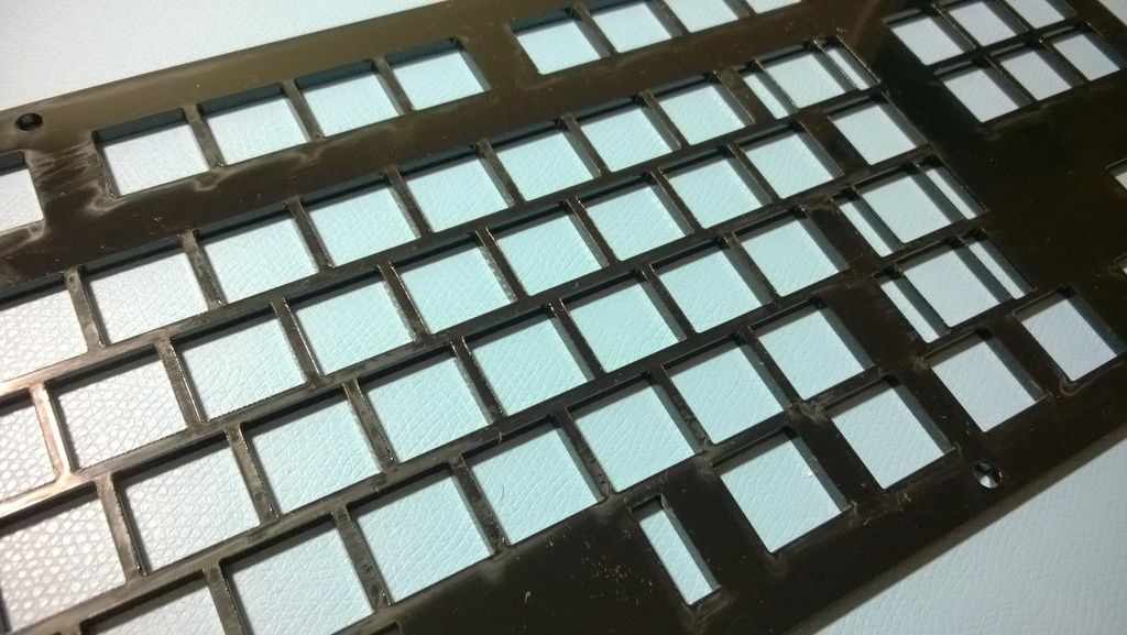

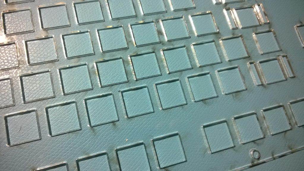

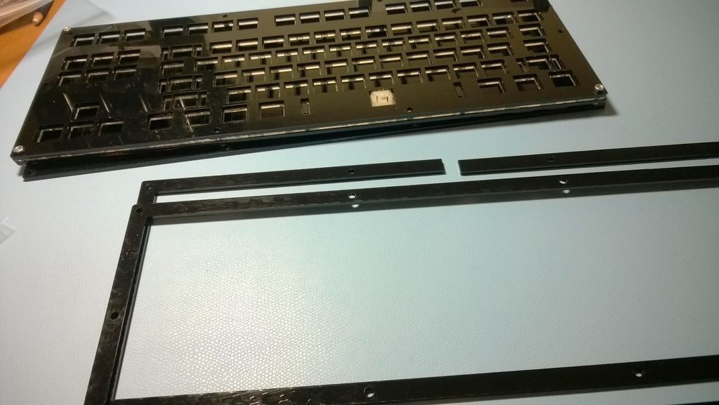

some more plates
Nice looking plates, I also enjoy codenaming stuff "Arc"s
Where/How were they produced?
1.5mm clear acrylic from ponoko.com
I paid $50 ($10 materials, $40 services) for 3 plates, 2 back plates and 2 middle pieces on this round. Not a bad deal! They're close by so I just picked it up locally and saved on shipping.
How did you get the .dxf file to work right when you uploaded it to their website? I keep getting a message that my line colors are wrong and I have tried everything to fix it... EDIT: Nevermind, I figured it out. They currently have a deal where you can get $20 off the first thing you make with them if you order within 10 days of creating an account, so hopefully the stabilizer calculations get worked out so I can get a plate for cheap.

I made my sandwich with Swill's builder, 4mm semi-frost, 6mm frost acrylic and my uni's crappy laser cutter. The laser was weak so it had to go over cut lines again for 6mm, here are the results:
4 pieces for 2 boards.
and put together:
As you can see the acrylic edge is 'going inwards', compared to metal plates which were 'professionally cut' (if you live in NZ don't go to HSM). Probably the laser's fault though.
I used M3 10mm standoffs for those hexagons (http://www.ebay.com/itm/261283813262?_trksid=p2060353.m2749.l2649&ssPageName=STRK%3AMEBIDX%3AIT) and the cut dimension is 5.5mm inscribed which fit fine. M3 5mm screws: http://www.ebay.com/itm/111471636269?_trksid=p2060353.m2749.l2649&var=410467517385&ssPageName=STRK%3AMEBIDX%3AIT
Also thank you Swill for the stabiliser fix!
Edit: Current progress: http://puu.sh/hVchB.jpg  ;D
The reason that the acrylic isn't cut right is due to the two pass cutting, if your laser isn't powerful enough to cut in single pass or even the power and speed is not optimised in the case of a single pass for thicker sheets (>3mm), you'll get a taper and this is what happened in your case. One side of the acrylic is slightly wider than the other.
Yours is the first non-Korean custom case I've seen that used countersunk screws.  That's the design element that's been torturing me for my case design.  I thought I would have to get screws with a 100 or 110 degree chamfer to ensure that the screw was holding onto enough of the switch plate but I can't find screws like that anywhere.  I think there's a secret cabal that keeps those screws off the open market.  Did you chamfer the screw holes on the switch plate yourself or did you have the cutter do it?
Actually, I was the one that devised the method to use hex stand-offs in middle layers and countersunk screws on top and bottom layers. It was first used on the GHPad about a year or two back. The Koreans then followed.
« Last Edit: Sun, 31 May 2015, 02:33:25 by MOZ »
