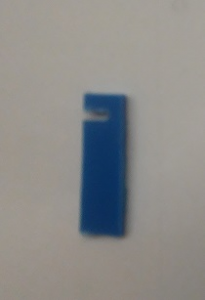

The space bar was the biggest challenge. After dremeling out the underside posts, I made two new
posts and cut slots for the stabilizer bar. I didn't think to take pics at the time but this is
what the posts looked like:

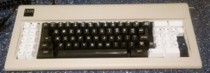

Results so far:
171005-6
The shift keys are in non-standard position but I found the keys fit best this way given the barrel
positions on the XT. I may still try rearranging a bit at some point.
I'm still debating the numpad section. Going to try some different color buttons on top and try
some different keys for the numpad + as well, but overall I don't think it looks too bad so far.

Replaced the numpad keys, still debating the surrounding keys:

« Reply #8 on: Mon, 31 July 2017, 20:38:09 »
Final version I think. The case color is a little off in the pic but I'm happy with how it looks in person.
