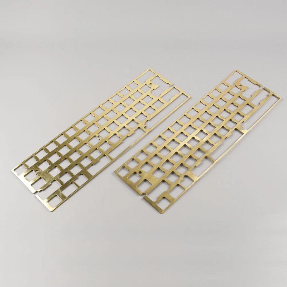

In general I'd say I prefer plastics like PC or POM for material over metals like aluminium, brass, or copper & say I prefer half plate to full plate (tray mount would be the only mounting type I'd opt for a full metal plate over a plastic half plate TBH). The difference between full & half plate is a full plate supports every switch on at least 2 sides like these plates,
Then a half plate only supports the modifier switches while there is no support for the alphas switches like this,
The ideal is to have the main alpha keys give a softer bottom out feel by removing the support the plate would give to them & allow for some flex further softening the feel & sound.
