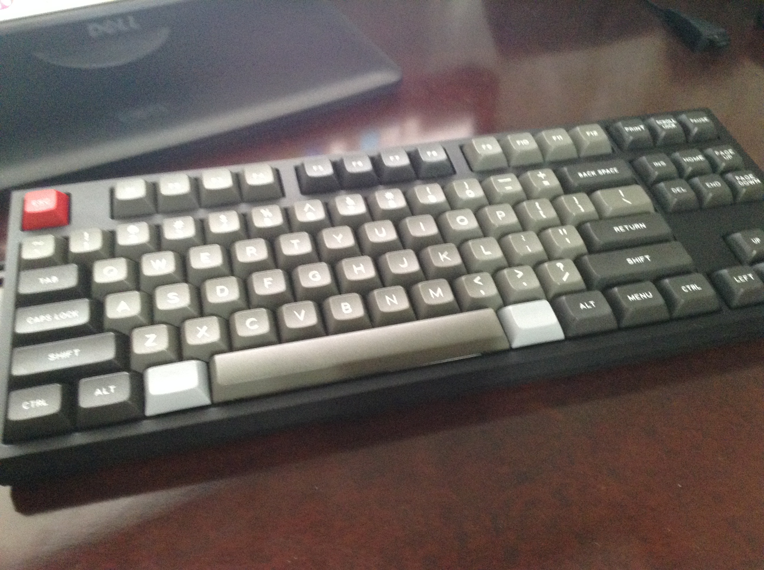

On the quest for a perfect green switched / clicky keyboard, I opened / modded each switch, then I segmented them, and selected switches for each key, left the bad switches for the F keys, saved the best for the space / modifers / and the letters / characters
I thought the space key should be the strongest of them all, so I selected a switch that produces a very strong/sharp click
Now after the keyboard is completed, I really can't handle the sharpness of the space key, it also didn't help that I used a red-switched keyboard while I was working on this one
The space key is piercing my brain at each space, it's very strong, now I'm thinking that the most used key on the keyboard should have been mellow instead
I tested externally lubing a single switch, picked a faultily modded one, that clicks too much, it successfully mellowed out the switch/click
Now the question is, should I try to adjust and enjoy, endure the pain for a while, or should I just mellow the space out, what do you guys think, should the space key be mellow, or strong and clicky?

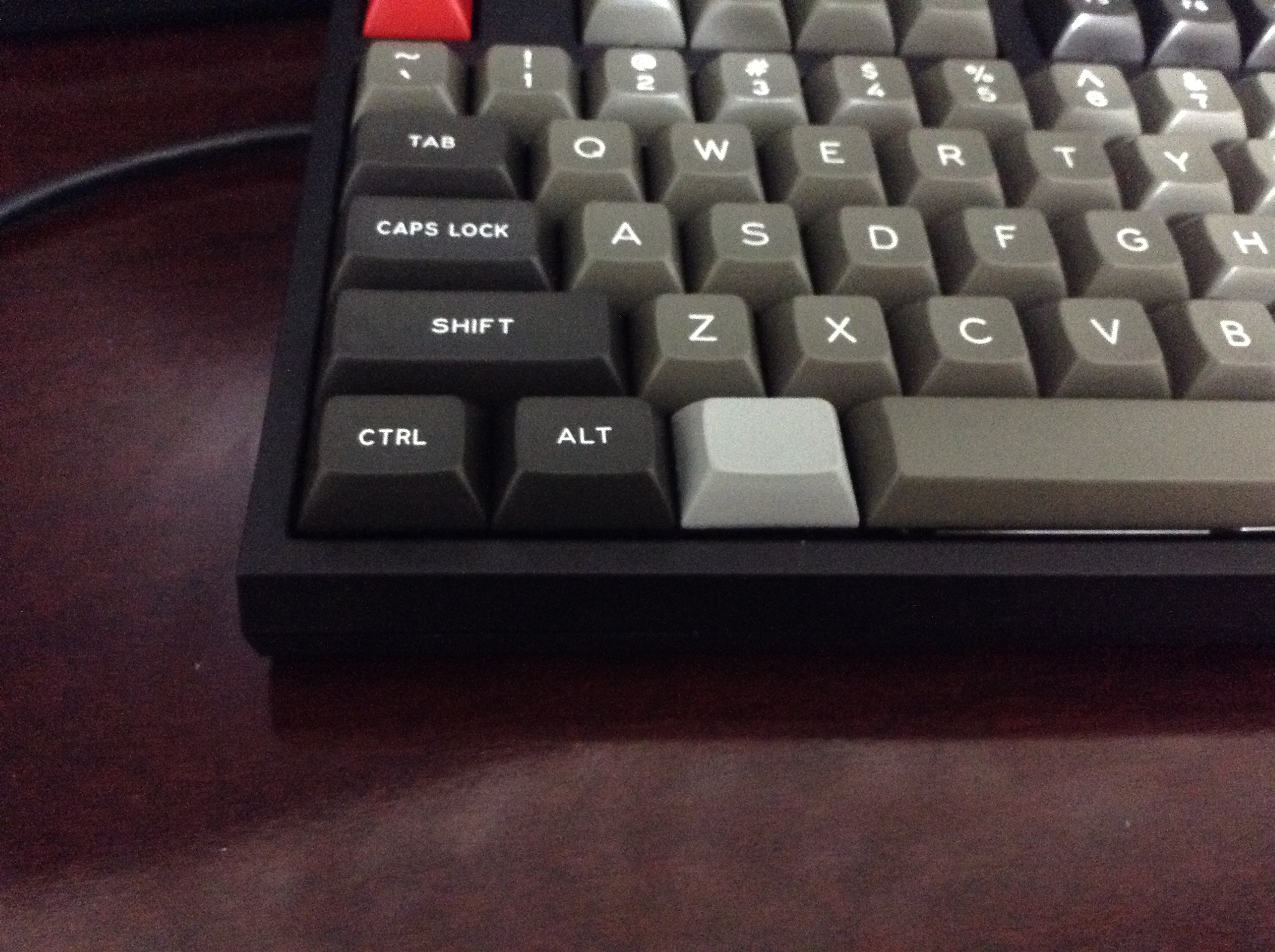

What do you guys think about the command keycaps?
I had a hard time deciding on what to use for them too, tried the Fn + Win from the Dolch set, but using the "Fn" key as a mac-command key was confusing on a micro-level, I also don't want to use the "Win" keycaps
This PBT blacks are a very different shade, I bought the 2 black and 1 gray shade that SP was selling, the blacks turned out to be identical (might be an error on sp's part), and the gray looks almost white with the Dolch's:
