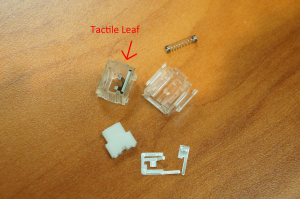

I think generally when you press down the switch the metal deforms and make contact and sends the signal to notify the computer that the key switch is pressed.  And when you let go it bounce back to original shape.

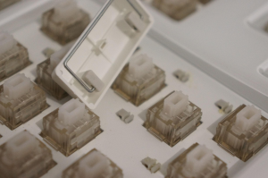

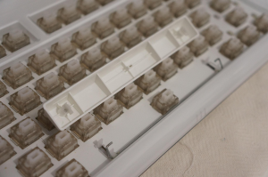

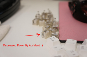

Just recently I try to do a switch swap on my g/f's keyboard going from Matias' Tactile Switch to Quiet Switch.  At the time it didn't occur to me that when I dissemble the switches and let it sit on the table, some of the switches were left in a "depressed" position.  Now that I think back I wonder if it would deform the "tactile leaf" since it's sitting in a depressed position for maybe 3 hours (as oppose to when we type which probably deforms it for 1/5 of a second).
What do you guys think?  Or does the metal should be flexible enough that it shouldn't effect it for too much?  I'm kinda paranoid now  >____>
My g/f claims that it feels the same but I think it feels less tactile now.  Here are some pictures to illustrate what happened:

On a side note, Matias uses a Costar-Like stabilizers for those that are interested.  All the large keys use their own type of stabilizers except spacebar which uses another different type that is actually closer to Costar design but not the same.

I personally conjecture that it would not deform that quickly. Metal springs(including plate springs as seen in your photo) are pretty sturdy. Of course, if you put excessive force to bend it, then it would deform, but I think it would be fine if it stayed in a switch.

So I did a test last night.  I compressed one of the extra switches I had for 3 hours before I go to sleep.
And I gotta say it felt almost exactly the same, since I don't have any accurate measuring device I kinda went by "feel".  I'd say it feels almost identical or even if it does deform it slightly I think it would be within a 5% difference.
Now I can relax and not worry about this case anymore  :D
