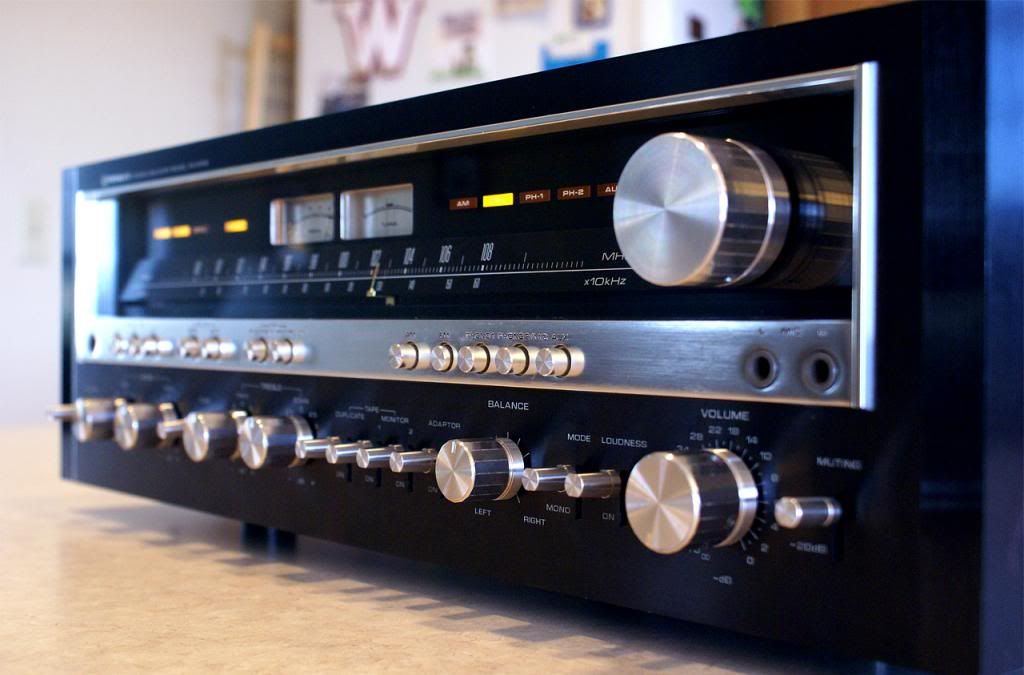

Wait... You like vintage Sansui?

Wait... You like vintage Sansui? Sorry for the potato, but this is mine.
Little to new for my taste :p  I like the 70's  "silver face" stuff.  That being said I have no doubt that is a solid amp.

Not mine but:
A Pioneer SX-5590
