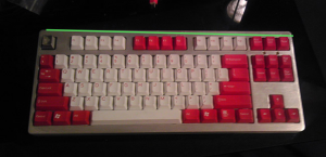

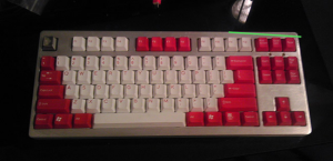

In photo A the top edge on the keyboard is "perfectly" straight from the left side until about F10 where it drops 0.8mm towards the pause key before reaching the corner. In blasted/anodized form, it was impossible to spot, I was surprised when I found it, I figured the entire thing was milled, it wasn't. As I sanded, I found evidence that it was raw, blasted casting surface. It was only when sanding it with a straight edge that it revealed itself as not being straight.
Before:
125230-0
After I squared it up, I got the whole thing pretty straight across the entire length, however the right side is still about .4mm shorter than the left. You can hold it up to light, you can look down the edges, doesn't matter, unless you have a micrometer or a very precise square, you can't see it. Blurry or not, it wouldn't show up.
125232-1
