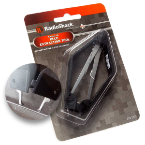

If you have problems with ic pullers bending on you, you can use the kind that are bi-directional, they lift towards you as you put extra pressure on them, they are very quick.
They look like this:
187548-0
I want to point out that these can damage things if not used correctly tho. If you are misaligned so you aren't depressing the clips, it will rip right through the plastic from the mechanical advantage. They also don't spring open on their own, so it can be awkward in tight spaces.
Personally I would like a traditional IC puller that doesn't bend outwards on you on tough to pull switches, but I haven't found one yet.
