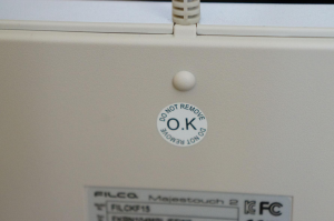

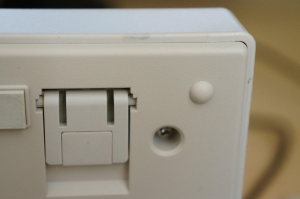

My Filco wobbles on my desk but doesn't wobble on my g/f's desk, so I think my desk is probably slightly warped.  BUT if you flip over your keyboard you'll notice two mini dome in the middle top and middle bottom.  I suspect those dome touches the table to make it wobble.  (there's more of those dome on the left and right corner too)  So I'm guessing you can either:
1. Sand off those domes and let it purely sits on the rubber legs.  (But if you plan to resell it then it might be a bad idea)
3998-0
4000-1

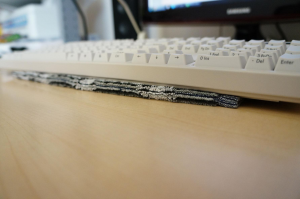

2. Fold a face towel in half and put it under the keyboard.  I'm using this method now it also absorb "desk echo" and make your keyboard sound better when you type.  Drawback is it look a bit ghetto depends on what colour towel you put down.  But I highly recommend trying the towel method first it makes my keyboard sound so much better.
4002-2
EDIT:  Added Pictures.  Also after some thoughts, probably don't sand off the domes at the bottom (Method #1).  They're probably there for a reason so let's just leave it at that :P

lol did you try the towel method?  I started trying that because I didn't like how my desk echo when I type, so I figured I need something to act as damper.  Turns out towel is cheap and effective, also doesn't damage the keyboard in anyway and make it sounds much better in my opinion.
Though my girlfriend refuse to try this because it looks ugly LOL.
Also if you guys find a better material than towel let me know.  I've tried mousepads while they look better but they're a bit too hard and less effective at reducing the noise.
« Last Edit: Mon, 10 September 2012, 00:08:49 by Hyde »

I think it looks pretty neat :D Better still, it's easier to reposition the keyboard especially when playing fps games.
lol looking good !!! Haha yeah it's true I do like the fact it makes it easier to reposition when I need the room to eat instant noodle :P Also I should really just go out and buy a plain black face towel or something.

Sorry to dig up this thread again... But when the towel idea was first posed I scoffed at it thinking it was dumb and looked bad. But I just tried putting my sweater under my keyboard with Blues and it sounds so much better! Now looking around the house for a nice small towel for long-term use.
