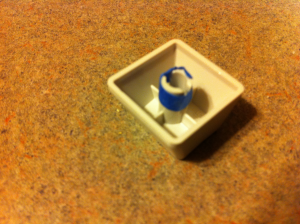

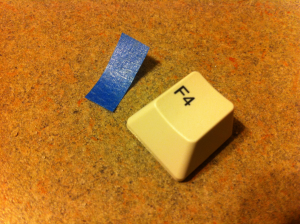

I notice that 90% of the sound the keys make comes from the motion of the key springing back up to its unpressed position after being pressed. It's hard to explain, but it's a kind of "looseness" in the plastic keycap as it fits inside the switch cylinder.
My idea was to put a thin piece of tape (a type of tape that has some texture/friction) around the post of the keycap, then reinsert the keycap post into the switch cylinder. I thought it was a brilliant idea, but it didn't work. At all. The key sounded just the same.
19542-019544-119546-219548-3
Has anyone tried this kind of modification on a Topre switch and had any success?
Short of super-gluing the keycap to the cylinder, I can't think of a way to make the keys less loose and prone to making that plastic sound effect when bouncing back up into position. I actually thought of gluing them (which I think would work since the keycap post sits stationary inside the switch cylinder and they both move down together as one unit). Kind of a drastic and permanent mod though...

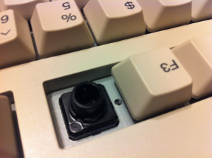

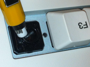

I decided to just go for it with the hot glue gun.
I did the function keys F9 through F12. I removed the four keycaps, warmed up the glue gun, then squeezed a sizeable drop of glue directly into each switch cylinder.
19706-019708-119710-219712-3
While I did this a small voice in the back of my mind was saying, ‘you’ve finally lost it.”
I quickly replaced each keycap after filling each cylinder with glue. I let the keys sit there a while to allow the glue to harden.
So, the result? I wish I could proudly say my theory was right all along, but it turns out the glue had no discernible effect whatsoever. You can still hear the plastic rattling by running your fingers just over the keycaps, and to my dismay I found no difference at all between the regular and the modded keys.

dude take a keycap off and wiggle the ****in cylinder if you don't believe that's where the rattle comes from.
it has been suggessted that the quiet cylinders are slightly snugger but i cant remember if that's been measured or not.

It has nothing to do with the key caps. If your key cap is what is rattling, then it's a broken key cap, or the stem is defective in some way. The rattling happens simply from the slider moving inside of the housing. Adding o-rings, or like o2dazone's washer mod will mostly remove that rattle. The tolerances are pretty tight, despite the rattle sound. Original topre key caps are meant to snap in very snug, removing the chance of them being the culprit.
On the silenced versions, the design of the slider differs. If you look at the mods posted in previous comments, you can see this.

it has been suggested that the quiet cylinders are slightly snugger but i cant remember if that's been measured or not.
I thought of a way I could test (roughly) how much of the rattle sound is coming from the space between the cylinder and the hole it fits through, in the 86U: by placing a small square of paper (folded once or twice) and wedging it between the cylinder and the hole edge (basically preventing the cylinder from moving at all, either up down or side to side).
I could do this on a couple of keys and see if it has any effect on the keycap rattle sound (the test will be just running my fingers lightly over the keycaps and listening how much chatter they produce).

I'm not sure if you've seen the previous posts, but it appears the rattling has nothing to do with the keycaps..

on a side note, if you REALLY REALLY want to make it snugger, you can apply heat to the Inner surface, while cooling the outer surface of the plunger
the heat will soften the inside, while the outside rim reduces slightly in contraction..
This is risky though :D
I've done it with Larger plastic pipes,, these plungers are smaller, but the principle is Sound...
