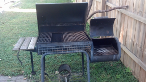

I am going to assume that you already have a smoker and wood but for clarity sake I will provide a pic of my smoker setup.
37068-0

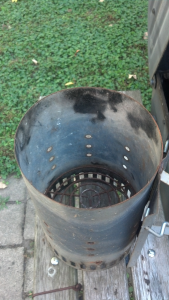

here is a shot of the chimney style charcoal starter that I use.  Note the wire rack in the bottom not a stamped plate.  The wire version works much better simply pour charcoal in the top and put 2 loosley wadded up full squares of non glossy newspaper in the bottom and light that on fire.  Don't worry about the ink if it is from non glossy paper the ink is actually soy based.

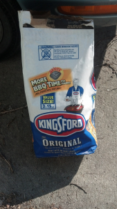

Now to the actual smoking process.  Set all the meat on the smoker after the charcoal has ashed over.  I usually start with about 6 briquets and 3-5 pieces of wood.  I do not use chips as they tend to burn up to quick.  Here is a shot of the charcoal I use and a good image of the first charge of wood and charcoal.
37072-2

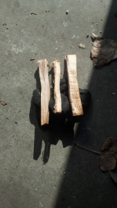

and here is the first charge there is 6 birquets.  5 in a ring and one on top.  Now the wood in this shot is a bit longer that what I would normally use.  So, what I would do here is let it burn for a while and then move what was left to on top of the charcoal.
37074-3
