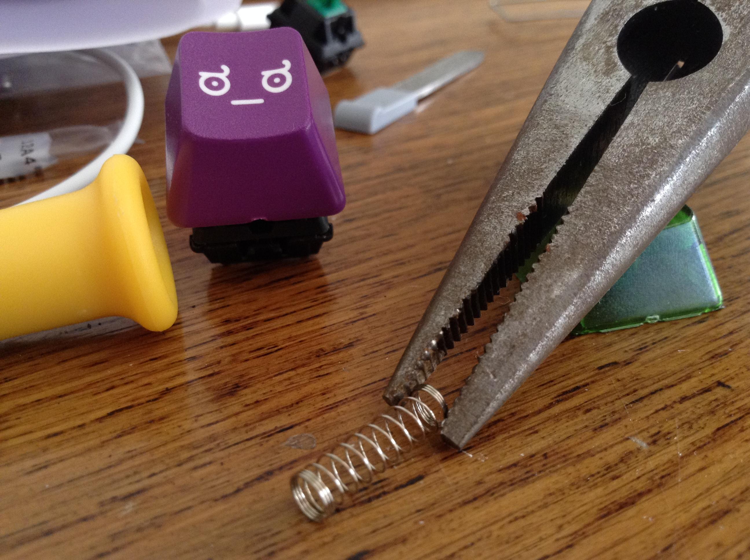

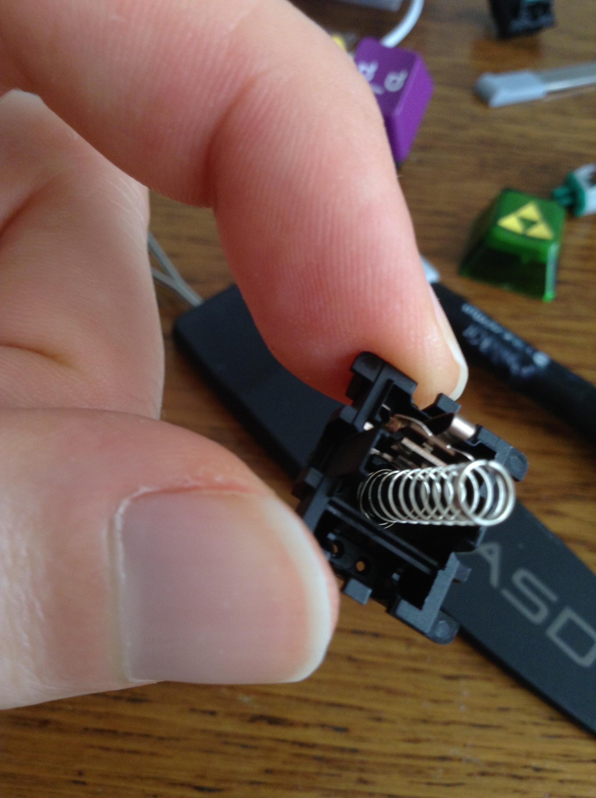

Cherry MX Quality
I got 20 spare green switches today, tested them all, out of the 20, only 4 were pingless / crisp, just wow. Of the other 16, 3-4 had extreme sound issues, the others were just meh~, the ping didn't resonate too much.
The Solution
My theory was correct, it's indeed the loose spring that causes the ping, at one point I thought it was the switch contacts, yet that's not the case, it's 100% the loose springs, some springs aren't loose, therefore they don't cause the ping sound
The solution is to disassemble the switch, squeeze one end with a plier and insert that end to the switch base, in my last trial, I squeezed the spring too much, mutilating it, then I had to push the spring down with a screwdriver, I couldn't describe how crisp the resulting switch was, just beautiful, pure crispness
Now I have to resolder 87 switchez, but in the end, I will probably have a keyboard worth fables, I'm even thinking of renewing the board, and put it into the replacement enclosure WASD sent me, as I damaged the enclosure slightly at one of my previous trials
I also want to thank WASD for the initial lead, a lot of people bashed the CODE keyboard for the pings, I asked WASD for a solution, Weyman told me the switches were the issue, and they indeed are, Cherry should definitely get those springs under control
For those who want to fix their switches too:
92167-0
92169-1
yeah, feels good to find a working solution :)

« Reply #16 on: Sun, 01 March 2015, 02:50:44 »
Lube the spring,
stop the ping.
Glad you found another solution, but I think lubing is a little easier. Surprised nobody else mentioned it yet.
Unfortunately, In my limited experience, lubing the spring also stops the click (as the lube also jumps to the 2-part stem), it might work for clears tho (also it's logical that it might also increase the ping, as the cause seems the free movement of the spring, in the long run the lube might move down and help the ping, as it will let the spring move freely, it highly depends on the viscosity of the lube tho)
Also lubing is comparatively harder and more delicate, seems more risky too, as the lube will most probably cover the entire housing (from inside) with each click in the long run, but I'm guessing that will have no damage, still ...
The only risk in this method is: also pinching the upper part of the spring, pinching both parts, pinching the part that holds the stem isn't needed, yet the switch seems more solid that way, yet the stem part needs to be pinched very slightly, as the green/blue part of the stem should move freely from the white part, and the upper spring might touch the white part of the stem if it's warped too much, which would cause the click to be affected / even prevented
To sum up, pinching the bottom part of the spring hard, so that it really grips the bottom housing, and pinching the upper part of the spring very slightly, so it still moves in the stem, but doesn't have as much room to vibrate -> works wonders
I will apply the method to the entire switch array soon, after the dolch keyset arrives and I have a chance to assess whether other modifications are needed, like sanding some of the keys etc. better do them before changing the keyset, as my soldering might not hold for too many keyset changes :)
So I will have a better assessment after the mod is complete, I'm guessing the keyboard will feel extremely solid / ping free, yet have slightly higher activation requirements, as this process strengthens the spring slightly

Hmmm... Plate resonance can be stopped with some type of rubber making contact with the plate in a few spots / areas to absorb the vibration.
It makes sense that stiffer springs "ping" more, but I have found properly lubing (particularly the area which touches / rubs the post on the bottom casing) with "proper" lube (thin Krytox or Victorinox) cures it, at least in MX Clears. I don't see lubing the lower part of the case and bottom of the spring having much effect on the white part of the slider unless you use excessive amounts.
My mod would actually be simpler on the clear switches, as there is no risk of 2-part-stem interference, I basically squeeze the spring to make it hold onto whatever it's touching, you can't squeeze the stem-end too much as it might jam the stem on blue's/green's, yet it's definitely an option on clears
For the plate, I'm not sure those mods are effective, they certainly were not in my case, maybe putting rubber inside the plate and pcb before soldering might work, but such creating such a stress isn't easy, the plate might still oscillate
Here is a photo of my mod:
93703-0
It's not clear in the photo, yet the bottom of the spring is squeezed heavily, so that it really grips the pole, and the top is sqeeuez just a little bit, giving it an oval shape, so that it hold the inner part of the stem
It's possible to squeeze the top part very hard too for one part stems, as the spring will keep on working
At this point, I'm hoping that the stainless steel plate of the infinity keyboard won't ping, as for the switches, I will stick to red's/blue's
Edit: I see that I repeated myself a bit, for the plate tho, I even tried filling the edges of the keyboard with a reusable plastic dough that's used to stick stuff onto other stuff, also applied to the entire keyboard, squeeze-shut the keyboard, yet, even though the plate is secured and stuffed at that level, it still pings
There should probably be a metallurgical innovation / effort in this field, most keyboard makers seem to just concentrate on getting things together, I haven't seen one keyboard yet that advertises a solution to prevent plate pinging
