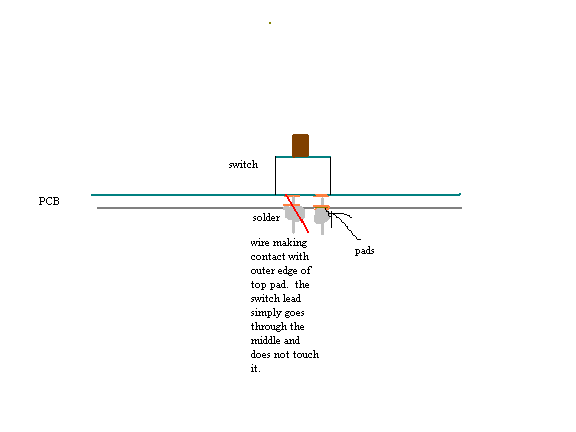

You may find that one of the leads from the switch pad leads to the diode.  If this is where the trace is severed you can solder a wire from the switch lead to the diode.  The other pad if you look carefully may not be attached to any leads or traces.  It's just a solder point.  The switch lead actually makes contact on the other side of the pcb.  What you can do is with a very this gauge wire ( you may have to sand it down thinner) melt the blob of solder securing the switch and have the piece of wire make contact at the edge of hole on the keycap side of the pcb.
This is a real pain in the arse and I find no matter how careful you are, Poker boards in particular always lost a trace or pad when desoldering.  I'll see if I can draw you a pic to better understand.

It's actually fairly simple, just tedious.  It's much harder with LED's.  I think that the pad on the bottom connects to the pad on the other side, which connects to the trace.  Now you can also strip 2 ends of a 5" piece of wire, solder it to the switch leads, and then make it connect to various contact points and depress the switch and see where it  actuates.  Unless the PCB is totally melted you can make a proper contact somewhere.  Without the pad the solder will be very difficult to flow through the hole, hence the piece of wire making contact at the edge of the opposite side
You are not the first person this has happened to and I'm sure somebody can chime in with their own technique for correcting this, possible better or easier than mine.  You can use Suicidal Orange's technique of soldering to adjacent keys, I just don't a zillion wires running around the bottom  of the pcb.  Perhaps his way is the more accepted way?
I've also had success putting a miniscule amount of solder at the base of the switch lead and at the plastic.  It's got to be paper thin or the switch won't sit right, but this will also make contact on the key cap side of the pcb.
