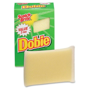

Similarly, the laundry soap seems to work better than dish soap on cases, too, and I swear by the "Dobie" scrubber for cleaning (including for actual cooking utensils). They are stronger and rougher than sponges, but not as harsh as Scotch-brite scouring pads - just right.
