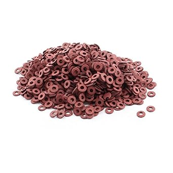

There is the spacer method.
Take some printer paper, each sheet is 0.1mm
Whatever the thickness your ring is,  offset that by the amount of sheets of paper..
Cut a little square with all the sheets layed together,  use a power drill to drill a hole in the center of the square. make enough squares for the amount of screws the board is held together by  then put that where the keyboard screws come together..

Insulating washers work better for spacing mod on hhkb than the paper fix described above. They're available in the perfect size already for use with hhkb and hyperspheres. I used tiny pieces of double sided tape to apply them to the screw standoffs (others have used light glue). Assembling the case after installation was a fraction more difficult due to the added gap, but worked out fine. Overall very pleased with the mod and return of full tactility on my hhkb.

That's a great idea.  I have a pair of NT's I'd like to test this on - one with the ironed landing pad mod and the other with Hypershpere rings (I prefer the landing pads).  As a point of reference, what thickness washer did you opt for?

I used fiber washers, like this guide shows.  http://imgur.com/a/DLuOw
Works well, but is quite the PITA to perform.

you don't need to do that  or (buy anything)..
just take some paper,  layer it, and cut a hole in it..  it will work just as well.
it doesn't even have to be a (hole),  just a slit,  or even the screw straight through the paper with no cutting will work.

Yes tp4, but I am too lazy :) They are only $3 on ebay; seems like the cleaner solution to me and you get 50 pieces.

my point is,  the paper gives you 0.1mm gradations so you can get it very perfectly spaced,  the spacers you buy, they could give you 999 pieces,  but unless they're the right thickness.  it's all m00t no, the problem here is, we do not know precisely what thickness we need,  so there's some experimentation that needs to be done , and you can't do that with the spacers either ?
If anything,  at least experiment with the paper,  each layer is 0.1mm,   then when you figure out how many layers is good,   then find spacers that fit that specification,  although i don't see why the paper wouldn't work just as well, hahahaha

According to the guide posted by tameone, it should work out just fine with the 0.5mm washers. I'll rather try that before starting to fiddle with paper because... laaazy

So, (after reading the detailed description of the 1st post) - I don't see anywhere the *other* solution left (apart from shortening the slider legs, which is the other half of the mod - keeping the travel distance): would it be possible to make the dome-touching base of each slider 1mm thinner? I.e. dig into it with some large shallow bit, or polish it, or even file it? Or with some heat-based method? The slider would then touch the dome from a higher position - like the type-s does, even with the ring on, so that the tactility would be preserved.

you can do like i did and separate the pcb from the plate by adding a bunch of these mobo washers on each screw hole:
https://images-na.ssl-images-amazon.com/images/I/519M-GFa9UL._SX342_.jpg
