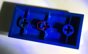

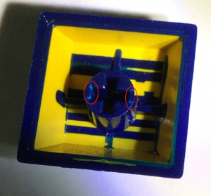

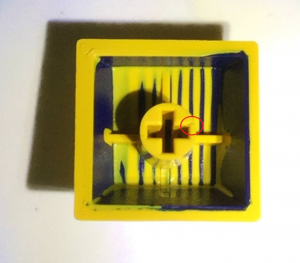

I can confirm the problem. Cracked stems on my GMK HADapter set which was mounted on Kailh BOX blacks.
This is horrendous. I don't even want to know how much damage has been done by this. All the expensive custom boards and expensive GMK sets rendered useless. This is absolutly insane.
Kailh needs to go out of business for this. Please don't buy from them anymore, I for sure won't.

Went over my royal hako board with the cap method, for some reason it was a lot harder than my previous two, I could see the little bits of horizontal stem being shaved off.
Kept reapplying the cap horizontally on each stem, testing vertically, reapplying, testing again, etc until the cap would fall off effortlessly to gravity or catapulting off from the hako clear springs.
Putting caps back on, I went to check them once again, one at a time with a bright light as I did so.  Now that I knew what to look for after seeing my cracked novelty, I found that
201877-0
Every. Single. Cap. was cracked or had stressmarks. Fug.

Since the switches were freshly "shaved" I took accents off and tried a monotone look using caps I had never used before.
201881-2
Checking them NOT MORE THAN THIRTY SECONDS LATER, I can see the beginnings of stress points. And these are switches I had reworked until they were "loose" with the stainless steel RAMA cap.
So in short DON'T PUT CAPS ON ANY BOX STEMS!.  I can't trust this shaving method will make them "safe" any longer.  Maybe I did it wrong, maybe the filing method will work better but at this point I'm just going to desolder everything.
