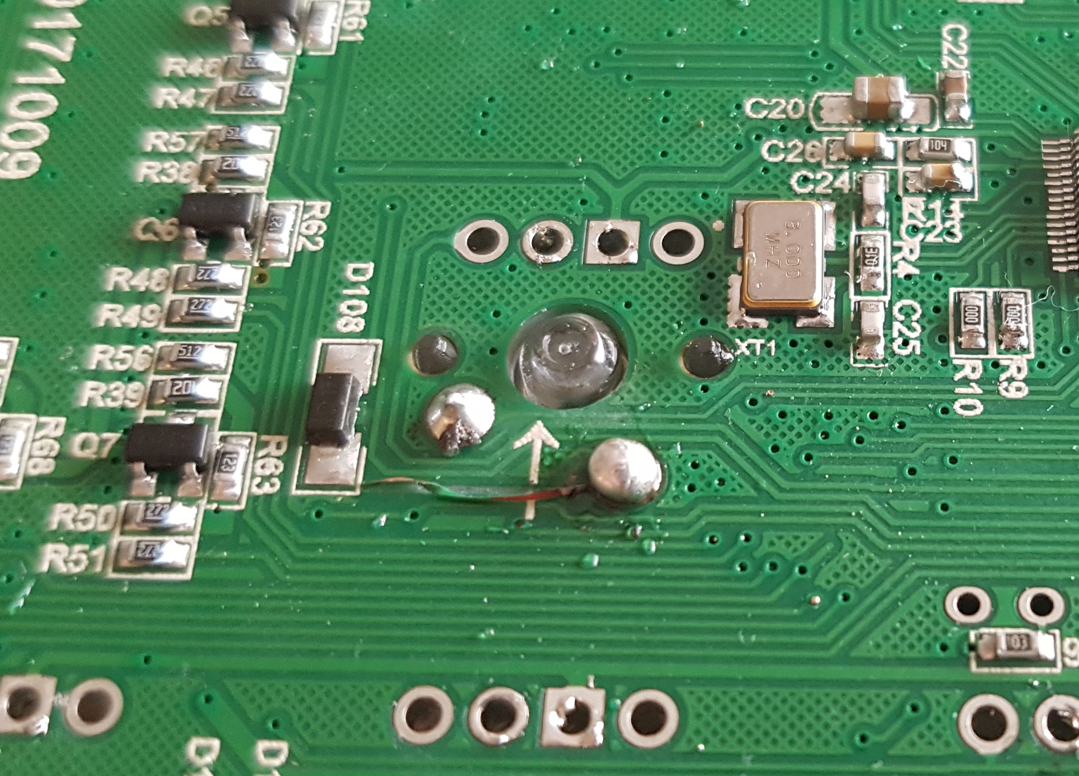

Please see those images, first one is up arrow - I think, I THINK... when I was taking off old switch I also took out that small ring that was on the pcb. Then I noticed that this thin long thingy - don't know how you call it - is coming off. It looks like a thin copper "route"?
I soldered it to that spot, but switch still not registering.

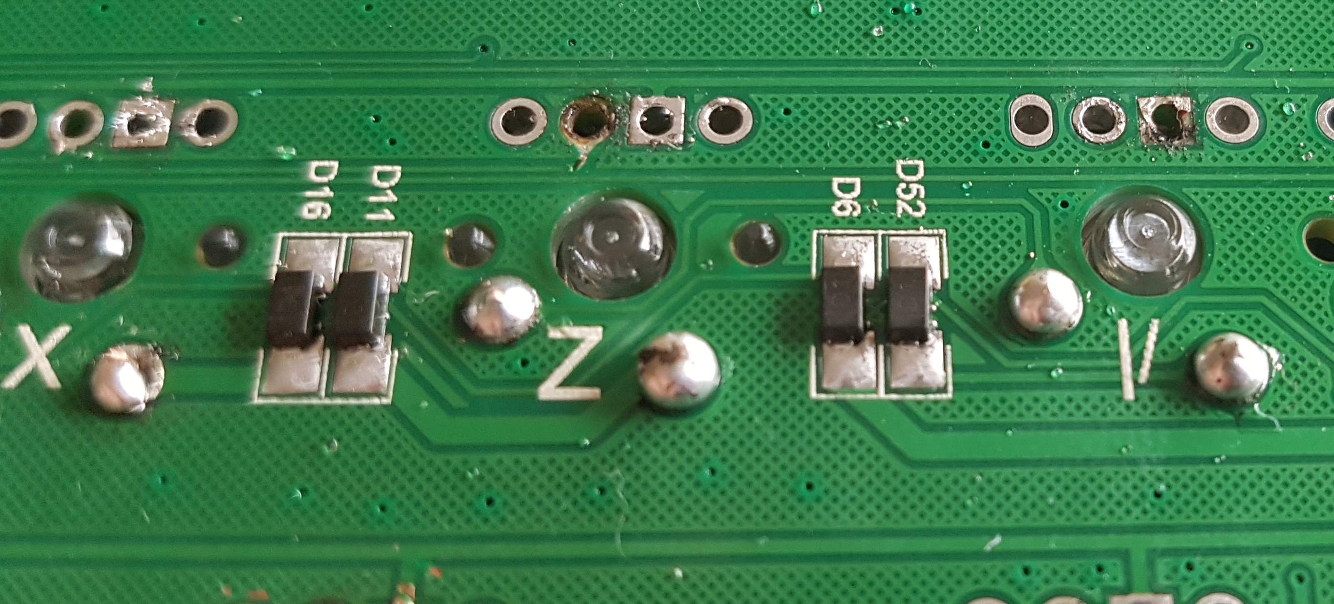

Second photo is "\" and "Z" - both not registering. One has lost this small ring on pcb, but other one was fine.
Please ignore those burnt holes over the switches - those were leds - I was not able to get rid of them easily:(

All you need to do to fix this is run a wire where the trace should go - in the top pic that's clearly from the bottom switch pin to the bottom of D108.
\| and Z are connected on their top pins so chances are this should continue.  If you touch the bottom pin (right of the Z label) to the top pin of X does it output a Z?  If it does solder a wire between the top pins of those switches.  Repeat for \| which may or may not work after fixing Z.

In the first picture, take a copper wire,  cut an old cable and pull out the copper,   And bridge the 2 points.

Thanks guys - arrow is now fixed!! :)
I wired that D108 with it and arrow now works:)

Maybe the problem is with Z bottom pin - I lost that small ring when desoldering - I just don't know what should I re-wire it with...

Now those Z and |\ - they in deed are connected with top pins. I have connected them with wire but still not working.
If it was the bottom ring of Z that got damaged that should be joined to the bottom of D11, then try the test above again (touch bottom pin to top pin of X) - it wouldn't work if both were broken :))
Cool.
So, when touching bottom Z with top X, it registers X. What does it mean?
Realforce 87u55 | CM QuickFire Rapid MX Blacks | Filco TKL 85g Oil Kings | Tiger Lite 85g Oil Kings | 2x Keychron C1 Pro Retro 85g Oil Kings | Sabre v2 Pro MG
  • Posts: 4771
Re: Soldering problem - need help !
« Reply #7 on: Sun, 10 March 2019, 10:15:12 »
It means soldering the top pin of Z to the top pin of X will make Z work.  And probably |\ too :)
Cool. I did that - now Z registers X and |\ registers "F1":(
What the hell is wrong with those two?

« Reply #9 on: Sun, 10 March 2019, 11:02:58 »
Oops - misread this X as a Z :-[
Needless to say you need to unsolder X-Z.  Try touching the top of A or S to the bottom of Z - you're looking to register a Z press...
Cool, I'll try that now - thanks for helping me with this - it is totally weird for me:)
Online phinix
  • Posts: 2503
  • Location: Haggis Land
« Reply #11 on: Sun, 10 March 2019, 12:16:30 »
Cool, I think I found it :
- top A + bottom Z = Z
- top A + bottom |\ = \
What should I do now?
  • Posts: 4771
« Reply #12 on: Sun, 10 March 2019, 12:26:39 »
Solder from the top of A to the top of |\ or Z (whichever has the least components to go round) and put it back in the case as it will be working properly.
Then go get some dinner :thumb:

« Reply #13 on: Sun, 10 March 2019, 14:03:39 »
Awesome! Thank you very much for help - it works fine now:)
My first resoldered keyboard is now completed - without your help it would be a disaster:)
