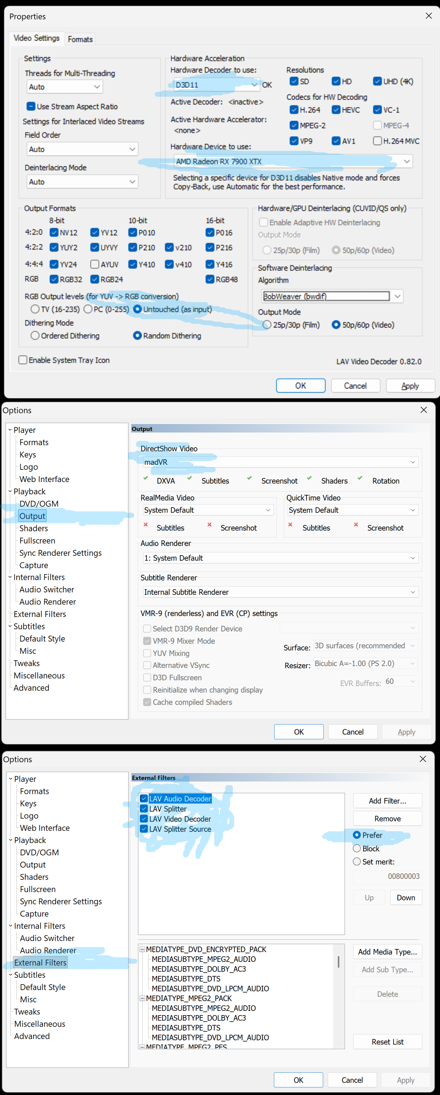

Once you install MPChc, you will also need to install Lav filter.
Set lav filter video decoding to dx11
Set mpchc to use Madvr renderer in the options menu under output>directshow video>madvr

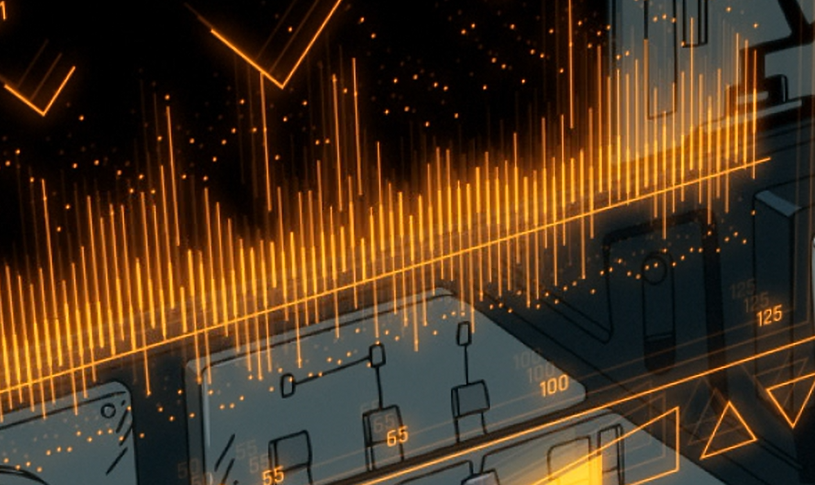

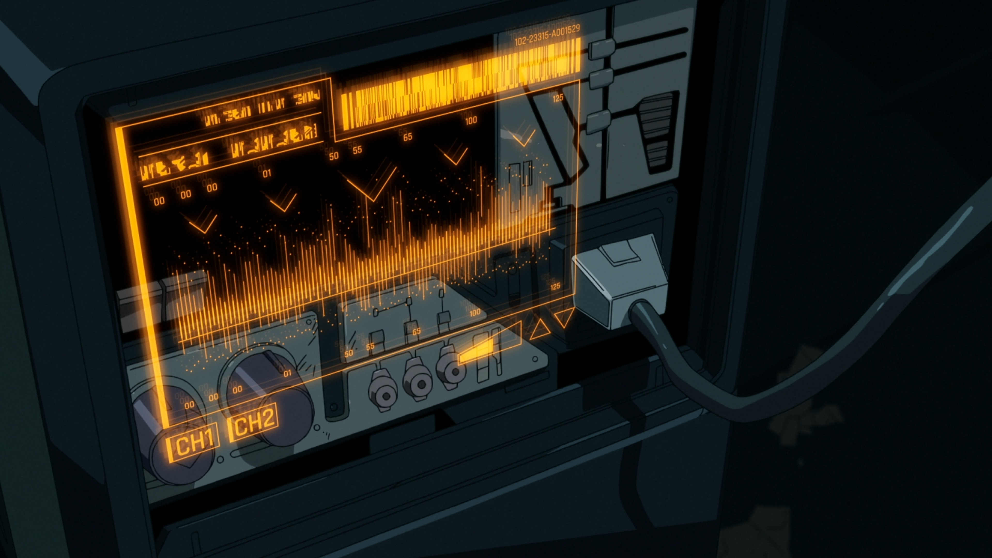

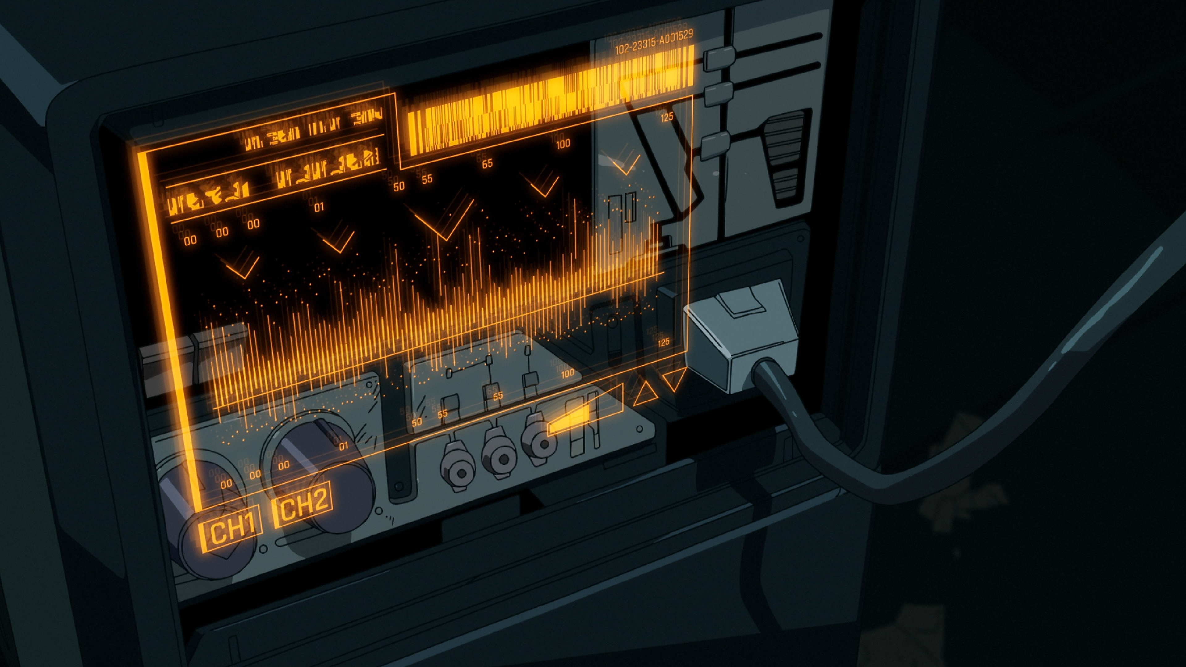

VLC
318451-0
MPCHC + MADVR
318453-1
VLC zoomed in
318467-2
MPCHC + MADVR zoomed in
318469-3

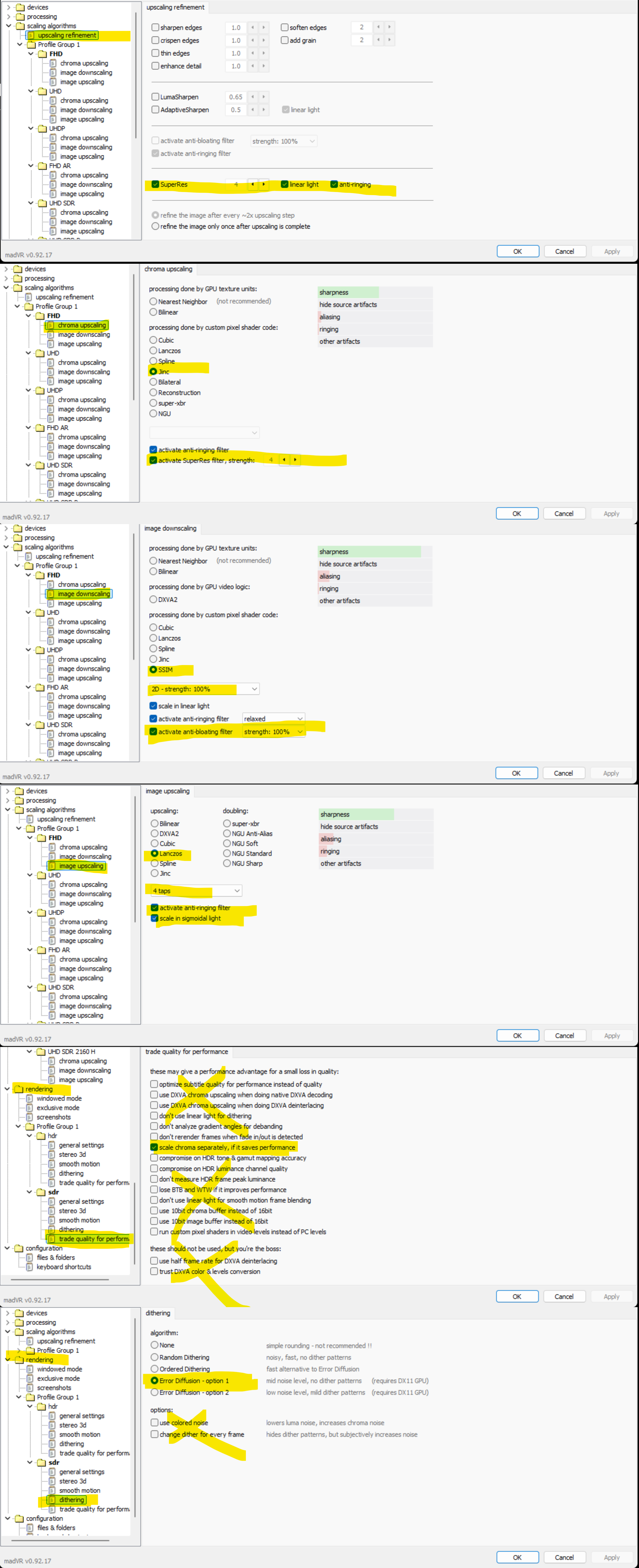

Starter Settings:
318479-4
318471-5
