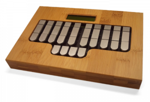

What about the stenosaurus? Have you considered to get it when it will be available?
Damn, I actually didn't realize that you need to hold two keys at once with a single finger. I've only done the first lesson here, then got frustrated with how uncomfortable it was holding my thumbs so close to the home row and decided to wait until I get my ergodox to do more.
50728-0
The keys seem so widely spaced on the Stenosaurus, how would you hold two at once? Do you only need to hold two keys along the columns, maybe? I did read something about square cherry MX keycaps, I'll try and find that later but not sure I'll be able to find it, might be hard to search for. I may ask the gurus in the keycap forum later. I'm kind of happy that my ergodox will have brown switches now, should be very easy to hold two down at once with browns...
I did notice from some of the pics that Mirabai posted of the prototype stenosaurus that it used Cherry MX blues.
You could probably dremel and glue up something that works ok for square caps. The ergodox is so customizable that I can't imagine there's many problems that couldn't be adequately solved with a bit of ingenuity.
I had considered the stenosaurus but I thought that it would be limited compared to the ergodox for my purposes. The ergodox has totally customizable layouts which is great. It looks more comfortable than the Stenosaurus to me. Any computer that I'd be using could have the Plover software installed, so I don't really need to have the steno "brains" in the keyboard itself.
Also the Stenosaurus isn't available yet, which is kind of a dealbreaker!! When I look at the blog at http://stenosaurus.blogspot.com.au/, it doesn't even sound like it's close. They've only just worked out how to load a bootloader by 22nd December 2013. I did see a video on youtube showing the stenosaurus "speaking it's first words", just typing "Plover" into a notepad window when a button is pushed. I noticed that the Plover software was running on the machine though, so the stenosaurus wasn't doing qwerty output, the pc was the "brains". So to my mind, the stenosaurus seems pretty far off.
Stenosaurus would be cool because it can work with any computer without having to install the Plover software though. If I end up becoming attached to steno, which I think I will, I will probably end up buying one anyway.
Yes. If you need to press two adjacent keys on a column you flatten your finger little bit and position it on the gap between the keys. Some theories include also combinations like *R and SZ which require pressing keys on adjacent rows. For this you need widened * and DZ keys which as I have understood will be made available for the stenosaurus additionally to the regural keys.
I imagine there would be quite a large torsional force on the switches with such wide keys on it. I wonder how smoothly the switches would work on the stenosaurus with those wider keys.
With square keys on an ergodox, it should be very easy to hold down two adjacent keys using the one finger.
BTW I tried holding down two keys with the one finger on my CM Quickfire TK with brown switches, and it is very easy to do this, the browns have such a low activation force. I think this would be easy to do with the ergodox assuming it also had brown switches. Super easy with square keys.
