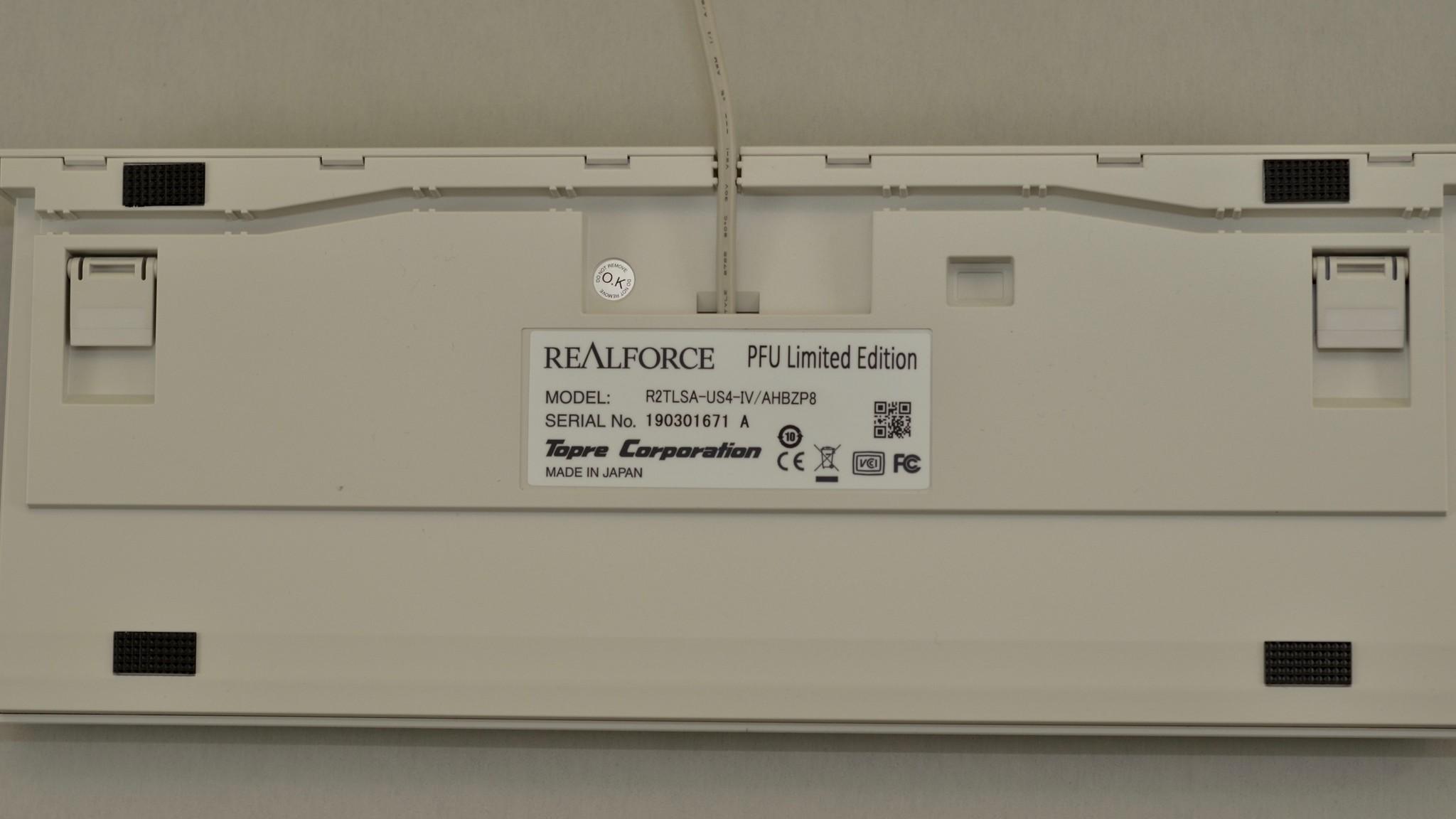

I'm trying to find out how to mod Realforce R2 keyboard, so it would have removable cable, or somehow USB socket, instead of stock cable.
Do you buys have any ideas?

I have pexons cables - I'm thinking of actual usb socket mod.
Pexon do those only with male USB-A plug at the end. They used to do female socket, but not anymore.
Best way would be to have a alu case with USB-C motherboard, but only one that is/was available was Norbaforce.

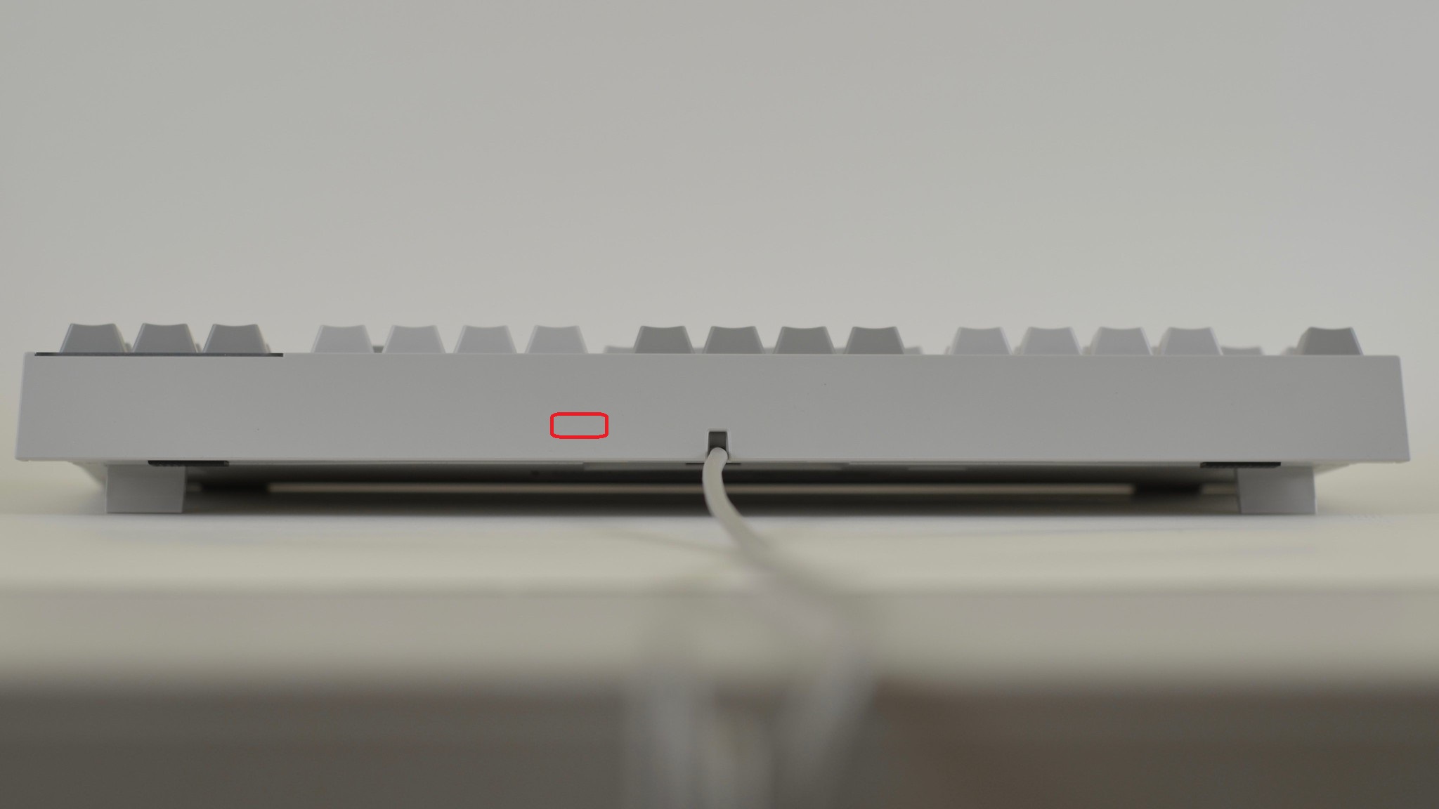

Yeah, I was thinking doing this.
I hoped someone already done something like that already...
I would prefer not to do much damage to actual chassis, but some solutions would involve cutting, drilling etc.
Ideally I would place USB-C daughterboard inside or under the case, with socket coming out at the back. But would need to figure out how I'm going to cover that small board.
Why HHKB is only one that comes with detachable cable...

Yes, my plan is very similar, only I'm going to use USB-C daugther board.
OR
make it simple, drill a hole in back panel and mount this, then somehow convert that rear plug to JST connector:
Question to our electronic geekhackers - how can I connect that usb-c plug with R2 JST connector inside the keyboard?

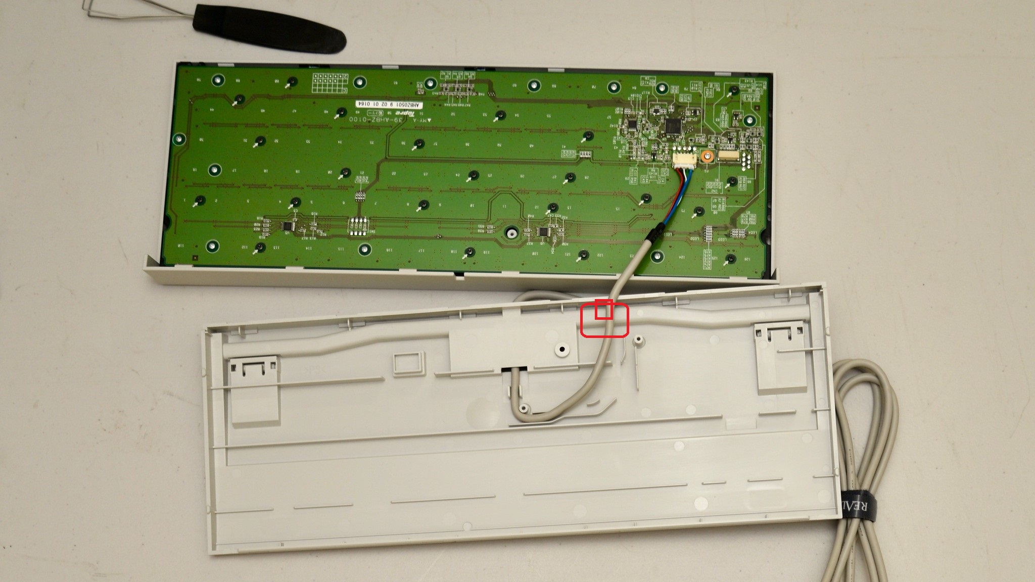

I'm thinking of using USB-C daughter board - think is those I can find hav 4 wires - so 5th - ground - is missing.
RF R1 had ground separated, now R2 has it in.
I would need a breakout board with 5 pin JST...

Guys, soldering is not a problem - as suicidal_orange mentioned, USB-C has 24 wires, I don't have any electronic testers/equipment or knowledge to test and find out.
I can solder simple 5 wires as I know which ones are in JST plug.
ALso, don't worry about breakout board position - I will mod keyboard casing to accomodate it - I picked a place as well - it will be 2-3cm from the center cable channel. I will take apart my R2 and measure all things later on, but I can screw breakout board down to bottom piece of case, dremel out some plastic, then wire it up to pcb. I would drill a nice, long rounded hole out on the back of the top case, so it would look nice.
245954-0
247985-1
245956-2
Only thing is to find out all electronic issues.
All USB-C breakout boards I find have 4 pin out socket for 4pin JST plub. How to connect them with R2's 5 pin?

It's using standard USB wire colours and Realforce are a quality company so no reason to think they wouldn't use the standard pinout leaving blue on the end as Shield (that's not supposed to be connected at the device)
If you look around the socket there are probably telltale capacitors on the power lines, a really fat ground trace and two parallel data traces heading off in the same direction for data - if you want to post a pic I'll have a look.

So you are saying that earth/shield is just a wire soldered to USB socket housing?
