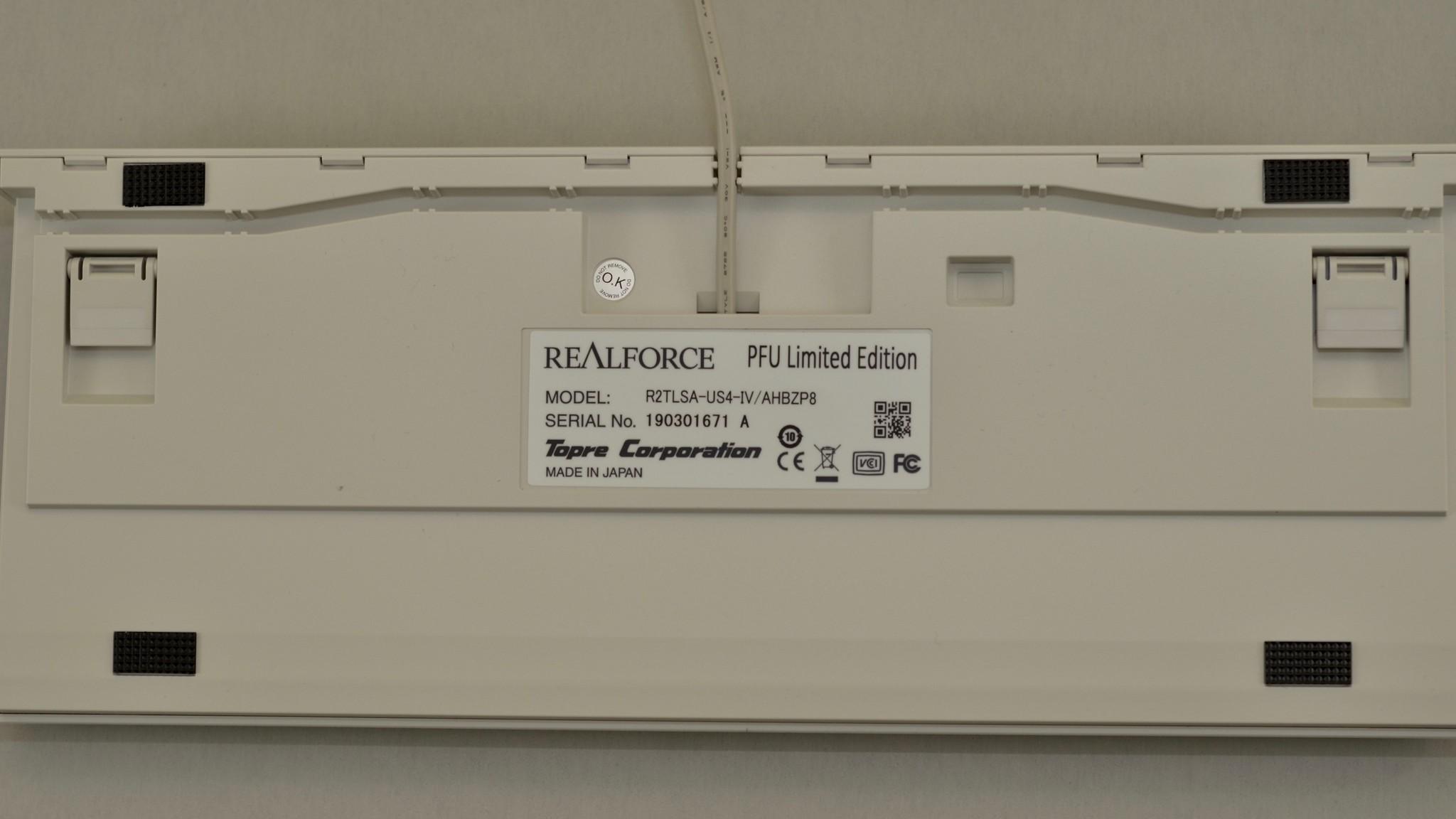

I'm trying to find out how to mod Realforce R2 keyboard, so it would have removable cable, or somehow USB socket, instead of stock cable.
Do you buys have any ideas?

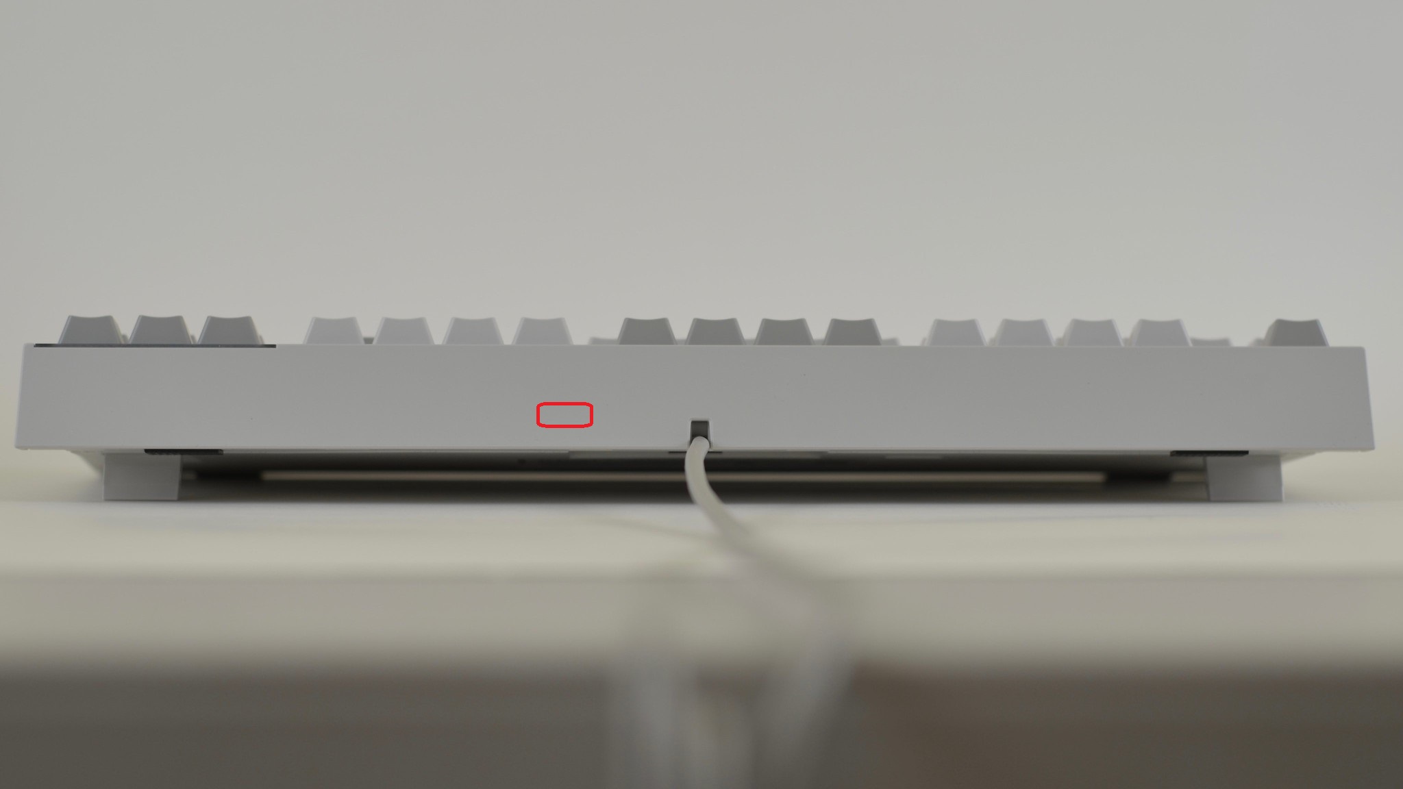

I would prefer not to do much damage to actual chassis, but some solutions would involve cutting, drilling etc.
Ideally I would place USB-C daughterboard inside or under the case, with socket coming out at the back. But would need to figure out how I'm going to cover that small board.

If I bother to customize something, I usually try to go through the trouble to make sure it is better than anything I can just buy, and like my things to be invincible to begin with if I can. When I add a removable cable to an existing keyboard, I drill a hole for a female GX12 aviator socket, rig it up to whatever the corresponding internal pins are, and make my own cable for it from male aviator connector to USB type A.
If the hole doesn't need to cut through a seam in the case, I use blue loctite to clamp the nut that holds the socket in place really snugly with a wrench, so that it shouldn't really ever come loose again unless I want it to. With the F77 I had to sort of resort to a bunch of high temperature hot glue.

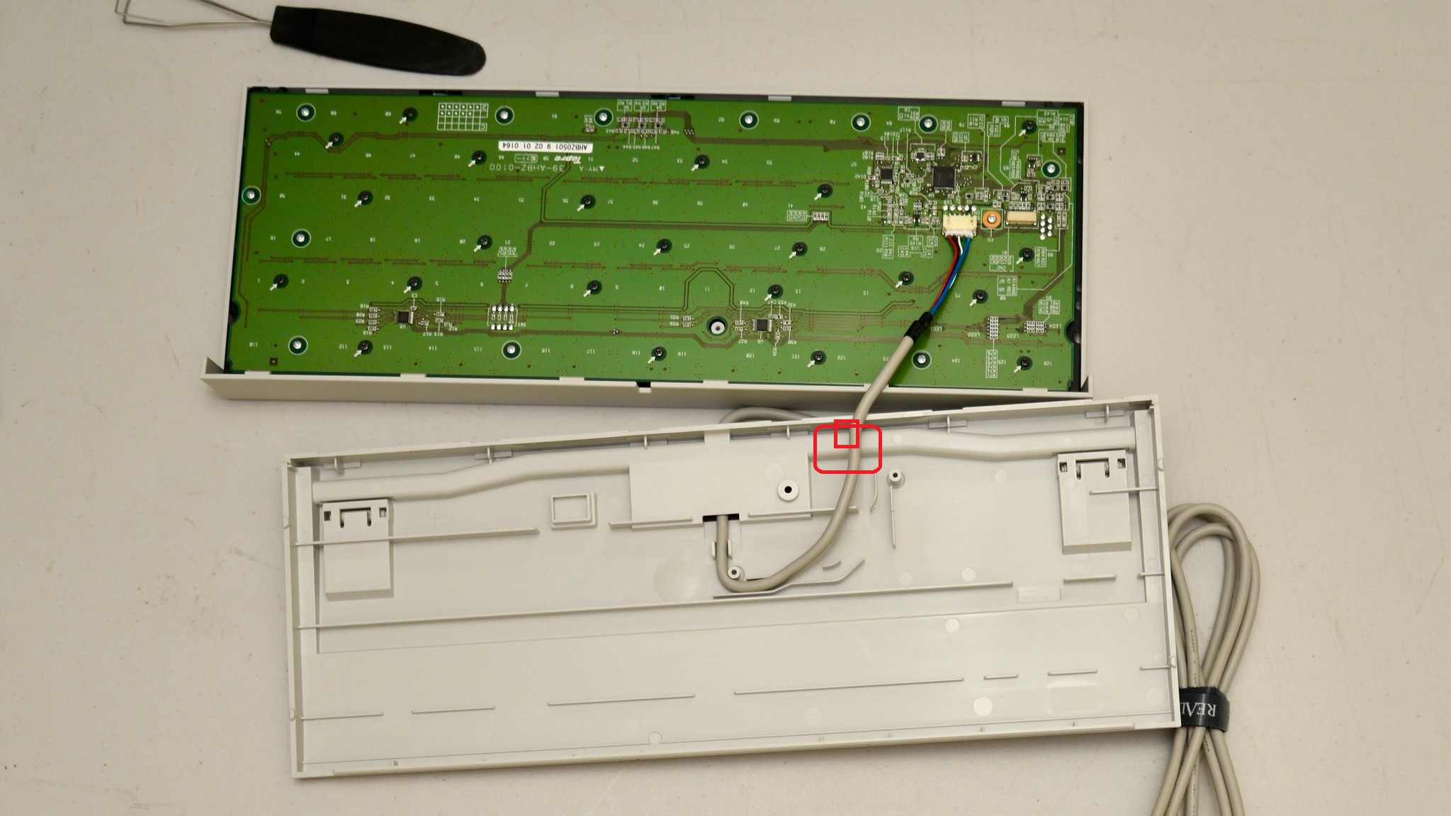

Yes, my plan is very similar, only I'm going to use USB-C daugther board.
OR
make it simple, drill a hole in back panel and mount this, then somehow convert that rear plug to JST connector:
Question to our electronic geekhackers - how can I connect that usb-c plug with R2 JST connector inside the keyboard?

I'm thinking of using USB-C daughter board - think is those I can find hav 4 wires - so 5th - ground - is missing.
RF R1 had ground separated, now R2 has it in.
I would need a breakout board with 5 pin JST...

Guys, soldering is not a problem - as suicidal_orange mentioned, USB-C has 24 wires, I don't have any electronic testers/equipment or knowledge to test and find out.
I can solder simple 5 wires as I know which ones are in JST plug.
ALso, don't worry about breakout board position - I will mod keyboard casing to accomodate it - I picked a place as well - it will be 2-3cm from the center cable channel. I will take apart my R2 and measure all things later on, but I can screw breakout board down to bottom piece of case, dremel out some plastic, then wire it up to pcb. I would drill a nice, long rounded hole out on the back of the top case, so it would look nice.
245954-0
247985-1
245956-2
Only thing is to find out all electronic issues.
All USB-C breakout boards I find have 4 pin out socket for 4pin JST plub. How to connect them with R2's 5 pin?

Offline phinix
  • Posts: 2500
  • Location: Haggis Land
Re: Realforce R2 cable mod
« Reply #36 on: Thu, 06 August 2020, 11:31:23 »
I decided to go with mini USB.
Was trying to over-engineer it :) No point.
I have a nice daughter board with mini USB, I'll go with this.
248826-0

Offline phinix
  • Posts: 2500
« Reply #38 on: Thu, 13 August 2020, 10:05:13 »
Unfortunately just found out that my dremel is dead, so till I get a new one, I did a simple mod, temporary solution without cutting the case - Norbaforce daughterboard and mini usb to usb C cable.
249417-0

Offline Maledicted
  • Posts: 2164
« Reply #39 on: Thu, 13 August 2020, 10:19:50 »
That works, I did something similar with a DC-2014 when I put a Soarer's converter inside of it, though I left a little extra cable sticking out to hopefully help prevent excess stress on the crappy micro USB connector.
