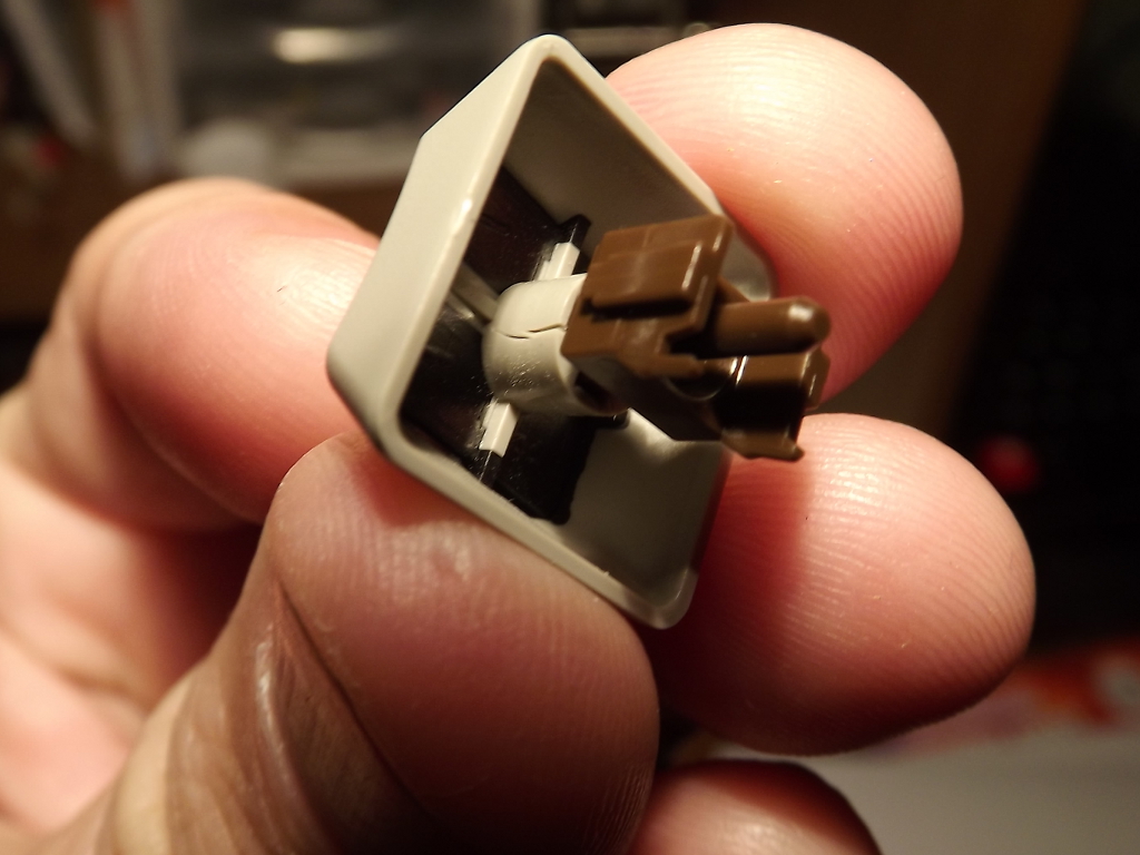

OK, I had a loose stem sitting here, so I tried a bunch of different keys:
- Vintage Cherry DS: I tried a few different caps (mods and alpha) from different sets.  They are a bit stiffer when rotated 90^ and don't snap onto the little notch in the top of the cross, but seem OK.
- SP: I'm pretty sure these are symmetrical in all four positions (which is why the Costar stabs fall out).  No problem.
- Vintage Wyse: very tight and the cap cracked and split open when I forced it on.
- "OEM" ABS: very tight, but managed to get it on and off.
- "OEM" PBT: very tight.  Needed pliers to get the stem out.
As it stands, I would prefer non-rotated switches.  If we proceed like this, I will probably modify the stems of those switches so that I don't run into problems.

^ See told you. Some caps work, some are very tight, and some just won't. Lol you cracked your vintage cap... that's no bueno especially if it's from a rare set. And any time they're tight enough where you need pliers, that means you're at a huge risk of ripping the switch right off the PCB.

Wow, that's nuts.  I've spot checked with a few caps of my own and had no real issues other than they're a little snug-er.
Old WYSE (Doubleshot ABS)
WASD (ABS)
Signature Plastics (Doubleshot ABS)
QWERKeys (ABS)
"Thin" PBT Set
Now I'm using some old Cherry Black switches I have, but I didn't use anything to install or remove the caps other than my fingers, and the switch was plate-mounted.  I could feel a difference on some caps rotating them, but nothing like cracking or any real stress.  The PBT ones were the "worst" but nothing I would feel uncomfortable installing.
But that said, I guess I haven't been thinking about PCB-mounting the things, either.  That really does make things a little different.  And I can't think of a PCB mounted board with rotated switches.
And a cracked cap is a definitive bad thing observed on a rotated stem.  I'm not 100% against, but at this point I can say I'd prefer not rotated.

Tested some of my keycaps as well at 90 degree rotation:
SP ABS DS: no problem (they are loose in first place)
KBC PBT (thin): Hard to get on, imo more loose afterwards
KBC ABS: Hard to get on, not sure if more loose afterwards
Scarface Al caps: Very hard to get on, stem gets damaged!
Imsto Ti caps: Hard to get on, slight wear on stem visible

This is a bad design desicion of Cherry I guess... they should have made the stem symmetrical to allow any rotation. I guess one must be extra careful when installing blank spherical keycaps, since you can't easily tell which orientation is right!
This picture from my Kinesis modification, where I added extra switches (some of them rotated) shows the difference in thickness of the sides of the stems clearly I think...
