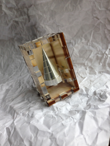

Yea, I know, it's ironic that I was recently stabbed..
This keycap is for the Anime Fans..
Probably, the most Dangerous Keycap made to date..
118890-0
Aluminum (cap), Aircraft wood + Acrylic (display case)
Been making some caps for fun while learning to machine..
I made this one completely Solo.
This build process utilizes:
cnc Lathe (turned at 2000 rpm)
cnc Laser (used to cut display case)
cnc EDM (electrical discharge machining)
Software used:
Solidworks 2015
Mastercam 9
If any of ya'll anime fans are interested.. well... some bad news....
I discussed it with the local shop again today,  they changed their minds since the last time they gave me a quote, and won't do anything under 100.. so pretty much not gonna happen.
The issue is, I don't have that much time to machine it on my own.. at most i can produce around 20..

That keycap is cool!

Also, keycap is cool. I don't know anything about anime, but I appreciate it nonetheless.

We fired one out of a CO2 gun that just happens to be the exact diameter of the cap 18mm (cherrymx)
we shot it straight up on a grass field hoping it would come down,  Never found it.
 So, theoretically..  It pierced the heavens, and/or someone's car..
But we're sure no one died,  cuz we checked the local news for 2 days.

I wonder if the spiral groove actually made it rotate as it flew through the air
Software used:
Solidworks 2015
Mastercam 9
Do you have a pic of the stem?
it's a cross cut, using the EDM machine.. I didn't take a pic of it, since it doesn't seem that interesting, lol.
You can't machine the corners like poured plastics. there are no bits that can make the corner..  Even with a laser, it'd be hard to get a smooth wall.
I could also make it on the cnc mill instead of edm, still under consideration.
I tried the "square cross" like the holyops, I didn't like it because I feel like these pegs need as muc structural support as possible.
